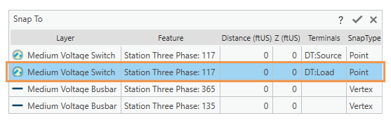

    The Snap To pop-up window appears.
  7. Click the row for the target feature in the Snap To pop-up window.

    A circle flashes at the target snap location for the selected feature.
  8. Click the Apply button in the Snap To pop-up window, or double-click the row.
    Alternatively, press Enter.
