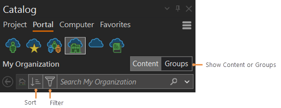

Portal tab in the Catalog pane
You can access portal content collections in the Catalog pane. In this example, My Organization is selected.

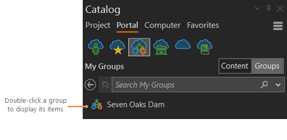

When My Groups is selected, the groups to which you belong appear when you click the Groups button. These groups can be browsed and searched. When you click the Content button, the content shared with these groups appears. Content items can be browsed, searched, filtered, and sorted.
When the Content button is selected, all group content appears in a single list—it is not organized by group. To see the items shared to a particular group, click the Groups button and double-click the group.
List of groups in My Groups in the Catalog pane
