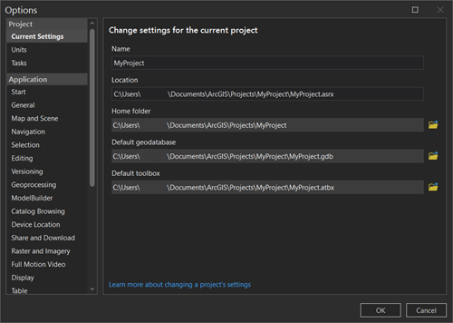

Current settings tab on the Options dialog box
Project name and location
When a project is created on a local or network computer, a project file is created with the .asrx file extension appended to the project name. Once a project has been created, it can't be moved or renamed in ArcGIS AllSource. However, you can save a copy of an existing project file to a new location with a new name.
The name of an open project and the path to its location are displayed on the Current Settings tab of the Options dialog box. They can be viewed but not edited. The project's name also appears in the application window above the ribbon.

Change current settings
You can change the home folder, default geodatabase, or default toolbox for an open project on the Options dialog box. You can also view the project name and location.
Alternatively, you can change the home folder, default geodatabase, and default toolbox on the ribbon when a catalog view is active, or in the Catalog pane.
Change settings on the Options dialog box
Follow the steps below to change the current project settings on the Options dialog box. If the item you want to designate as the default doesn't yet exist, first create a folder, create a geodatabase, or create a toolbox. In this workflow, you can designate an item as the default regardless of whether it has been added to the project.
  1. Open the project whose settings you want to change.
  2. On the ribbon, click the Project tab to access the ArcGIS AllSource settings.
  3. In the list of side tabs, click Options.
    The Options dialog box appears.
  4. In the Options dialog box, under Project, click Current Settings and change settings as appropriate:
    • To change the home folder, under Home folder, type the path to an existing folder where you have sufficient storage space to support the project. Alternatively, click Browse and browse to the folder.
    • To change the default geodatabase, under Default geodatabase, type the path to an existing geodatabase. Alternatively, click Browse and browse to the geodatabase.
    • To change the default toolbox, under Default toolbox, type the path to an existing toolbox. Alternatively, click Browse and browse to the toolbox.
  5. Click OK.
  6. On the Settings page, click the Back button to return to the project.
    The new settings take effect immediately. Connections to the previous home folder, default geodatabase, and default toolbox remain in the project. You can remove these connections if you no longer need them.
