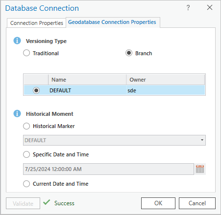

  1. Create an enterprise geodatabase named DataReviewer_Tutorial.
  2. Create a database connection.
    Note:
    Ensure that the Branch option is selected under Versioning Type.
    Database Connection dialog box with Branch versioning selected
    An enterprise geodatabase named DataReviewer_Tutorial is created and a new database connection is added in the Databases folder.

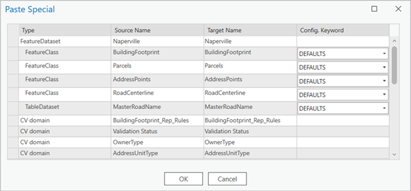

  4. Right-click the enterprise geodatabase and click Paste Special.
    The Paste Special dialog box appears, and the Naperville feature dataset is listed in the first row.
  5. Click OK.

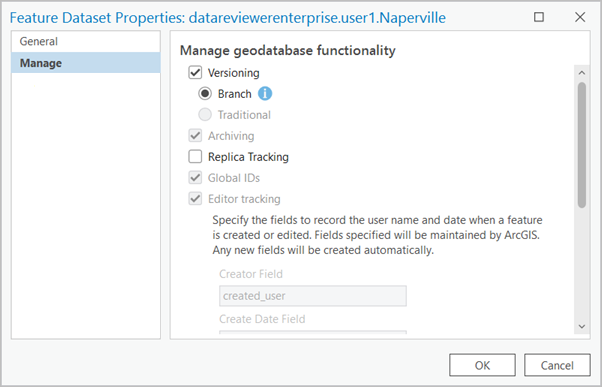

  7. In the Catalog pane, right-click the Naperville feature dataset in the enterprise geodatabase and click Manage.
    The Feature Dataset Properties dialog box appears with geodatabase properties in the Manage geodatabase functionality section.
    Feature Dataset Properties dialog box with the Manage tab selected
  8. On the Feature Dataset Properties dialog box, check the Versioning check box and choose the Branch option.
    Leave the Archiving, Global IDs, and Editor tracking check boxes checked (the default).
  9. Click OK to apply the geodatabase properties.

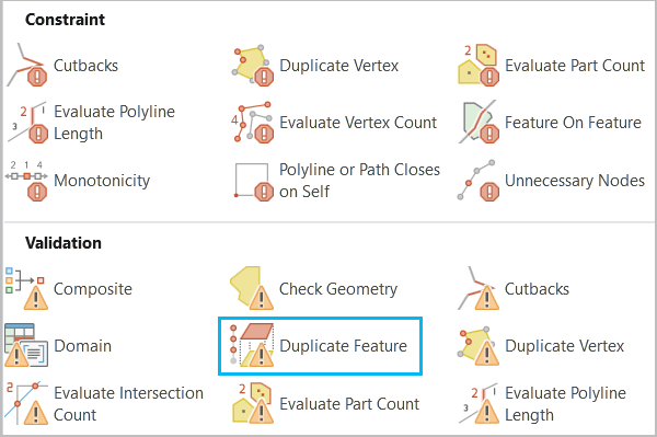

  2. On the Attribute Rules tab, in the Add Rules group, click the Ready to Use Rules drop-down gallery to display ArcGIS Data Reviewer automated checks.
    Note:
    The contents of the Ready to Use Rules gallery is a smart gallery that varies depending on the chosen data source.
  3. From the Ready to Use Rules gallery, in the Validation section, click Duplicate Feature to add a new rule.

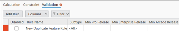

    The new rule appears in the Attribute Rules view with a red row header, indicating that required parameter values are missing from the rule's configuration.
    Attribute Rules view with required parameter values missing

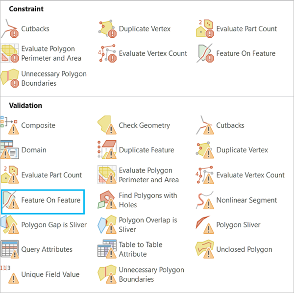

  2. On the Attribute Rules tab, in the Add Rules group, click the Ready to Use Rules drop-down arrow to display the gallery containing ArcGIS Data Reviewer automated checks.
  3. In the Validation section, click Feature On Feature to add a new rule.
    Feature On Feature check in the Ready to Use Rules gallery

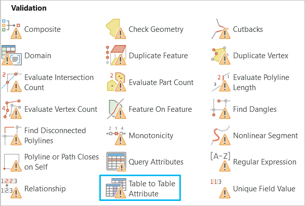

  3. From the Ready to Use Rules gallery, in the Validation section, click Table to Table Attribute to add a new rule.
    Table to Table Attribute check in the Ready to Use Rules gallery
