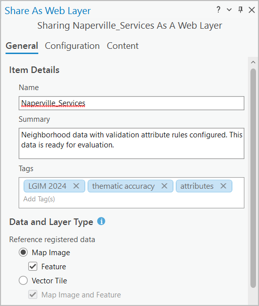

  4. Type Naperville_Services in the Name text box on the General tab of the Share As Web Layer pane.
  5. Optionally, provide a summary and add tags in the Summary and Tags text boxes.
  6. In the Reference registered data section, ensure that Map Image is selected, and check the Feature check box to share the web feature layer as a dependent layer to the map image layer.

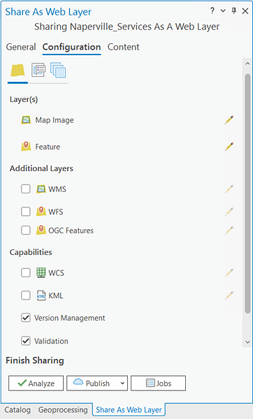

  9. On the Configuration tab, in the Configure Layers group, in the Capabilities section, check the Version Management and Validation check boxes.
    Capabilities section with Version Management and Validation checked
    The Version Management service is required to activate the data quality management capabilities provided by the Validation service.
