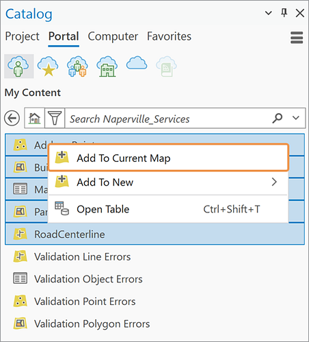

  6. Open the Catalog pane, and click the Portal tab.
  7. Double-click the Naperville_Service feature layer, and press Ctrl while clicking AddressPoints, BuildingFootprint, Master Road Name, Parcels, and RoadCenterline.
  8. Right-click one of the selected features, and click Add To Current Map.
    Catalog pane with Add To Current Map selected
    The layers are added to the map.

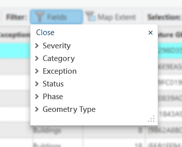

  1. In the Filter group, click Fields to display a list of error properties that can be used to filter the errors displayed in the Error Inspector pane.
    Fields filter options
  2. In the Severity section, check the 1 check box to only display features with a severity value of 1 in the Error Inspector pane.

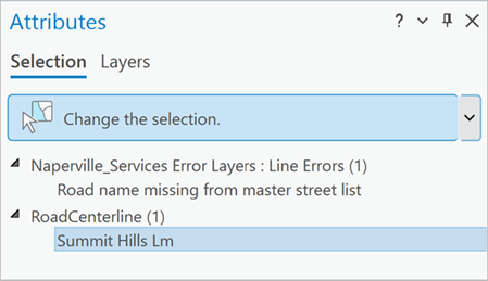

  5. On the Edit tab, click Attributes to open the Attributes pane.
  6. In the Attributes pane, click Change the selection and drag a rectangle across the road with the error to select it.
    Tip:
    Do not select any other layers.
    Selection of the Summit Hills Lm error layer
    RoadCenterline (1) appears in the Attributes pane.
  7. Click the RoadCenterline (1) drop-down arrow, and click Summit Hills Lm.

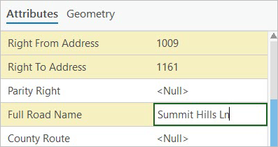

  8. On the Attributes tab, scroll to Full Road Name, change Lm to Ln, and press Enter.
    Corrected road name
  9. Click Apply.
