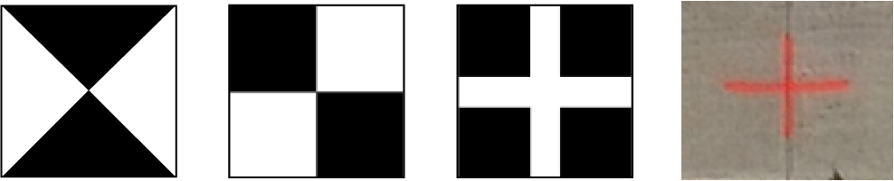

Supported control point markers
The automated control point detection capability of Drone2Map currently supports a select number of control point markers. Below are the type of control markers currently supported:
Checkerboard, cross and spray painted cross markers

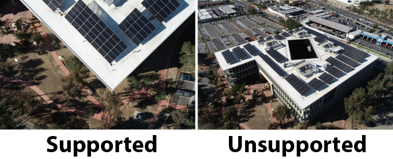

Supported flight modes
Additionally, the detection process can only be used with projects that have nadir-looking imagery. If you attempt to use automated control linking on an oblique angled flight, the points may fail to be detected. Additionally, the altitude values of the drone images must be accurate, as images with altitudes too far below or above the ground elevation may not detect control point markers accurately. These are limitations of the first models in use and will improve over time.
Supported and unsupported flight modes are shown in the following images:
Comparison of flight modes

  • Use ground control point markers like those that are pictured above to achieve the best detection results.
