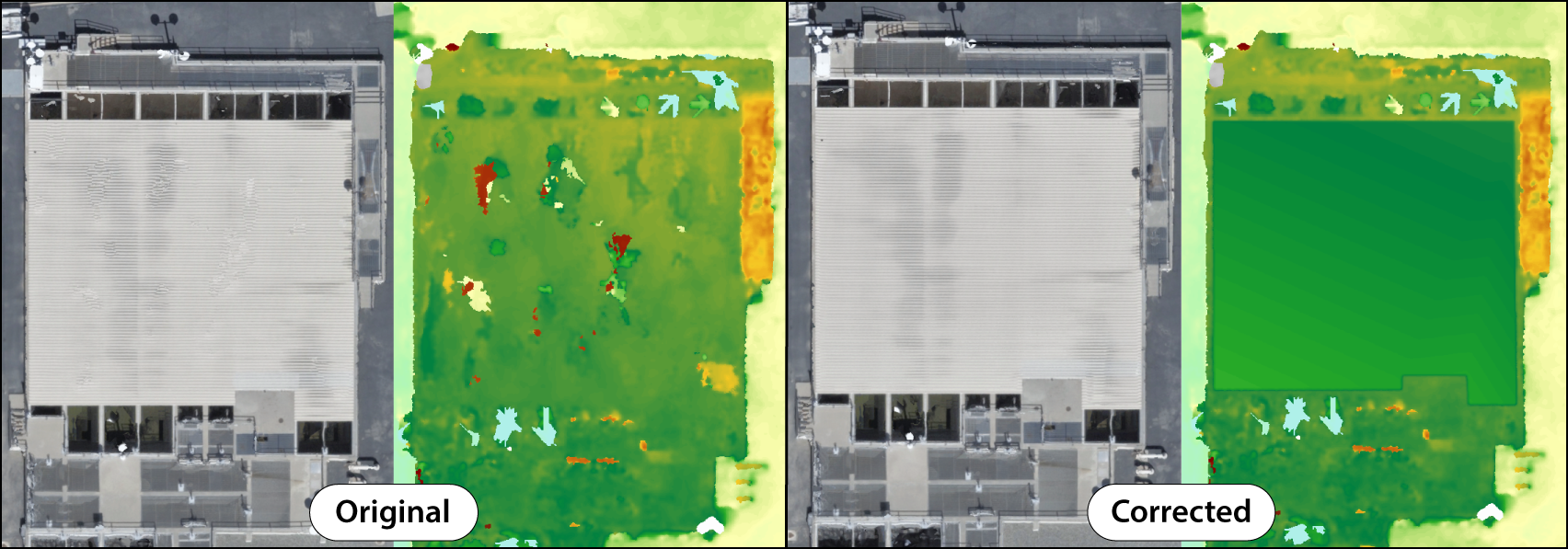

2D correction features
Correction features that are drawn with 2D geometry apply to the True Ortho and DSM products. They are best used when attempting to correct objects that are difficult to reconstruct, such as vegetated areas or complex materials. They can also be used to potentially close up any possible voids within a resulting product. If there are still issues with default settings, then configuring a project to the Ultra point cloud density setting will also generate a mesh that is used to correct the products during reprocessing.
One example of 2D correction features, would be if you were to draw a correction feature over a flat roof. The area within the correction feature polygon would be smoothed out to achieve a more uniform surface.
Correction feature results

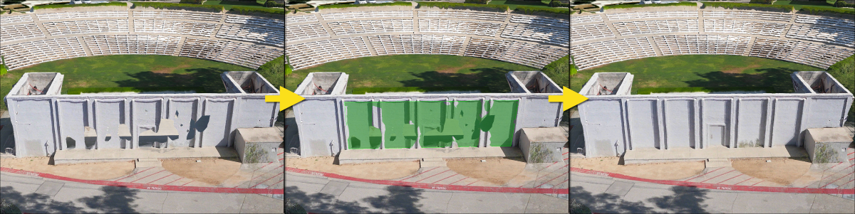

3D correction features
Correction features are drawn with 3D geometry and can be used to correct vertical areas within meshes. They work similarly to 2D corrections by flattening and filling in the area so that the mesh is conformed to match the drawn feature. They are most commonly used on objects that tend to be highly reflective or transparent like glass facades and roofs, as well as surfaces that lack distinct textures.
One example of using 3D correction features, would be correcting voids that appear within a 3D mesh. The area within the vertically drawn correction feature is void filled and smoothed out with the mesh texture then aligning with the new geometry.
3D Correction feature workflow
