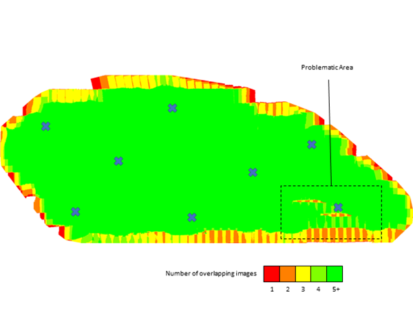

The more a control point appears in multiple images, the better the results. It is recommended that you avoid placing control at the edge of the project, where image overlap is reduced. Instead, offset control from the edge toward the center of the project to maximize overlap.
Assessing image overlap
Distribute control evenly throughout the project in a triangle grid pattern. Avoid placing control at the edge of the project where insufficient overlap decreases the effectiveness of control. In this project, an area of poor overlap was revealed through the Processing Report, which may affect the absolute accuracy of the project. Add manual tie points or additional images to fix the problematic area.

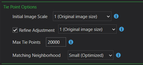

The tie points that are obtained from automatic feature matching during the Adjust Images processing step are used to estimate the 3D coordinates of the scene, which are then used in the bundle adjustment process to optimize the model. To maximize the absolute accuracy of your products, it is important that the individual keypoints that make up the tie points be as accurate as possible. To maximize the accuracy of the keypoints, Tie Point Options Image Scale should be set to 1 x (Original image size).
Tie Point Options
Note:
Increasing the Initial Image Scale setting improves the accuracy of your products while increasing the processing time.
The more keypoints that compose a tie point, the more accurate the estimated 3D coordinate becomes. The Matching Neighborhood setting specifies the images to use to search for matching keypoints. The Refine Adjustment option can be enabled to maximize the number of tie points generated.

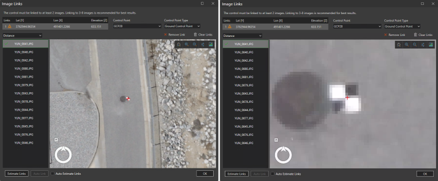

When incorporating control into your project, the location of the control is manually identified in each image through the Image Links editor. Diligence in marking the precise location of the control in all images correlates with the absolute accuracy of the final products. While this can be a daunting task on projects with several images and control, using the assisted links feature makes this process faster.
Digitize accurate control
In the example on the left, control has been roughly linked in the Image Links editor at a small scale to save time. While the image link appears to be placed correctly, zooming in (the example on the right) reveals that the image link is several pixels away from the center of the control. Incorrect placement of control links will degrade the accuracy of your control.
