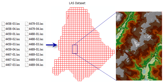

A LAS dataset stores references to one or more .las files on disk, as well as to additional surface features. A .las file is an industry-standard binary format for storing airborne lidar data. Optimized .las files (.zlas) are also supported with the LAS dataset. The LAS dataset allows you to examine .las files in their native format quickly and easily, providing detailed statistics and area coverage of the lidar data contained in the .las files.
A LAS dataset can also store references to feature classes containing surface constraints. Surface constraints are breaklines, water polygons, area boundaries, or any other type of surface feature enforced in the LAS dataset. Surface constraints are stored in geodatabase feature classes or shapefiles, which are usually derived from some sort of remote sensing technique such as photogrammetry. Surface constraints are enforced when the LAS dataset is drawn as a TIN surface model.
The LAS dataset does not import point data contained in the .las files. It stores a reference to those .las files and surface constraints.

You can quickly change the view of the LAS dataset into a TIN-based surface, similar to the TIN or terrain dataset display. The LAS dataset allows you to work with points classified into different feature types. There are several point and surface symbology renderers available for LAS datasets. The most common symbology for LAS datasets can be accessed quickly from the Symbology pane. Surface constraints are enforced when the LAS dataset is drawn as a TIN.
The LAS dataset default display in ArcGIS Drone2Map is as a point cloud with no filter applied. That means that all the lidar points display initially if zoomed to an extent, where thinned points display. Also, ArcGIS Drone2Map allows single .las and .zlas files to be displayed and used with all the same functionality as a LAS dataset.
