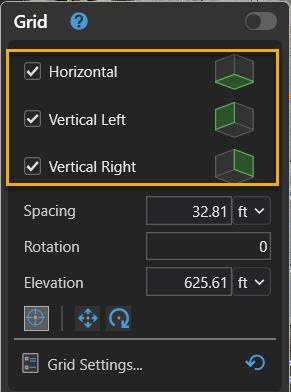

Turn the grid on or off
Turn the grid on to display the grids that are currently enabled. In 2D maps, the horizontal grid is automatically enabled. In 3D maps, the horizontal and vertical grids can be enabled and disabled separately.
  1. On the status bar at the bottom of the active map or scene, click Grid to turn the reference grids on or off.
    • If you are working in a 3D map, click the toggle button to enable or disable the horizontal and vertical grids.
      Horizontal and vertical grid options
      Note:
      The horizontal and vertical grid options are available only with 3D maps.

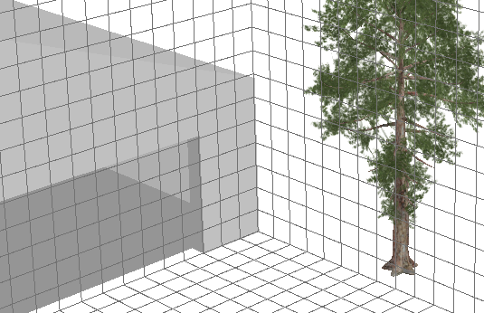

Reference grid
The horizontal grid and left and right vertical grids are shown in a 3D map.

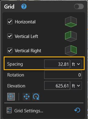

Change the spacing
Change the grid spacing to apply a distance uniformly to the horizontal and vertical grids.
  1. On the status bar at the bottom of the active map or scene, hover over Grid to show the pop-up dialog box.
  2. Click the Spacing text box, and type the distance and choose the units.
    Spacing
  3. Move the pointer back to the map to hide the dialog box.

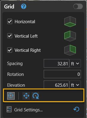

Change the origin and rotation
Change the origin and rotation at the same time to move the origin with the first click and rotation with the second click. In 3D maps, the first click also sets the elevation.
  1. On the Edit tab, in the Features group, enable your snapping preferences.
  2. On the status bar at the bottom of the active map or scene, hover over Grid to show the pop-up dialog box.
  3. On the Grid toolbar, click Set Origin and Rotation .
    Grid toolbar
    The grid toolbar appears at the bottom of the map or scene.
    Grid toolbar
  4. Click the origin location.
  5. Move the pointer to rotate the grid interactively.
  6. Click to set the rotation angle.
Change the origin
Change only the origin to preserve the current rotation angle. In 3D local scenes, the first click also sets the elevation.
  3. On the Grid toolbar, click Move .
    Grid toolbar
    Grid toolbar
  4. Click the new origin location.

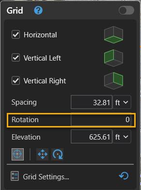

Change the rotation
Change only the rotation to preserve the origin location.
  3. To type the rotation angle, do the following:
    1. Click the Rotation text box and type the rotation angle.
      Grid Rotation
    2. Move the pointer back to the map to hide the dialog box.
  4. To use the pointer, do the following:
    1. On the Grid toolbar, click Rotate .
      Grid toolbar
      Grid toolbar
    2. Move the pointer to rotate the grid interactively.
    3. Click to set the rotation angle.

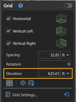

Change the elevation
In 3D local scenes, change only the elevation to preserve the current origin and rotation.
  1. On the status bar at the bottom of the active scene, hover over Grid to show the pop-up dialog box.
  2. Click the Elevation text box, and type the elevation value.
    Elevation
