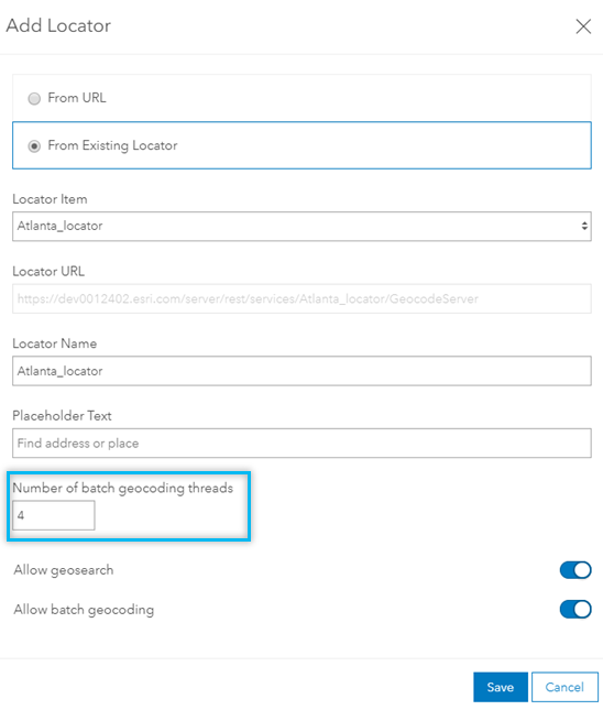

To set the suggested number of batch geocoding threads for your locator, follow these steps:
  1. Publish the desired locator to your portal using ArcGIS Pro.
  2. Sign in to your portal as an administrator.
  3. Click Content, and make sure the locator is shared with the organization.
  4. Click Organization, and under Settings, browse to Utility Services.
  5. Scroll down to the Geocoding section, and click Add Locator. Select the locator you want to configure for batch geocoding, and adjust the Number of batch geocoding threads value.
  6. Click OK and click Save.
Note:
The number of batch geocoding threads must be less than or equal to the number of instances available for the locator. If a greater value is selected, batch geocoding jobs may fail.
