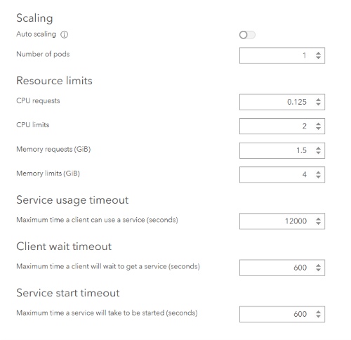

After you configure the organization to geocode addresses and share your locator from ArcGIS Pro, you must allocate the appropriate resources to the pod that is created. Depending on your deployment, you may need to allocate more resources to the pod so that the geocode service can function optimally. A geocode service deployment has the following specifications when first published from ArcGIS Pro:

CPU requests and Minimum requests equates to Kubernetes requests. This is the guaranteed amount of CPU and memory used by the pods. CPU limits and Memory limits equate to Kubernetes limits. This is the amount of CPU and memory that a pod is allowed to use. What is not used is free to be used by the Kubernetes cluster until it is needed.

The CPU limits value should equal the Minimum number of instances per pod and Maximum number of instances per pod values. Generally, one CPU per instance is necessary on the pod. By default, two CPUs are allocated when the service is first shared from ArcGIS Pro. If your Instances per pod value is greater than 2, ensure that the CPU limits value for the deployment is equal to the number of Instances per pod value.

  5. Click the Settings ribbon.
  6. Change the Number of pods, Memory limits (GiB), and CPU limits values for your organization based on the recommendations in the previous section.
  7. Click Save.
    The service spins up the pods and allocates memory according to your specifications.
