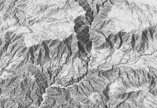

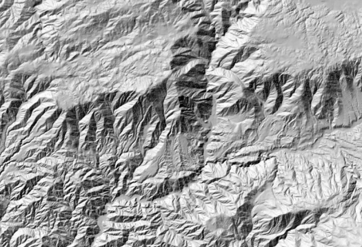

Traditional hillshade
This is an example of a traditional hillshaded image.
Multidirectional hillshade
This is an example of a multidirectional hillshaded image.

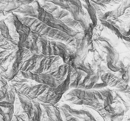

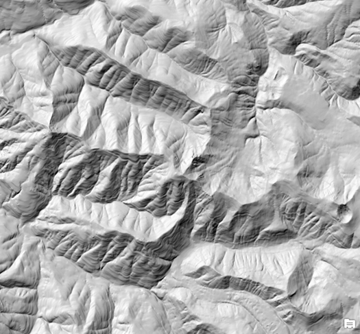

The following images display the two types of hillshade:
  • The top image shows the traditional hillshade result.
  • The bottom image shows the multidirectional hillshade result.
Traditional hillshade. The source DEM is courtesy of the U.S. Geological Survey (USGS).
Multidirectional hillshade. The source DEM is courtesy of the U.S. Geological Survey (USGS).
For more information about multidirectional hillshade, see Multi-Directional Hillshade Makes Your Maps Pop.
