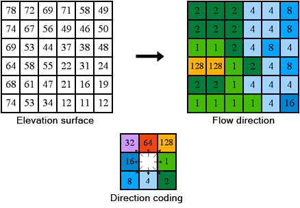

There are eight valid output directions relating to the eight adjacent cells into which flow could travel. This approach is commonly referred to as an eight-direction (D8) flow model and follows an approach presented in Jenson and Domingue (1988).
The coding of the direction of flow
The coding of the direction of flow is shown.
Calculate the direction of flow using the D8 method
In the D8 method, the direction of flow is determined by the direction of steepest descent, or maximum drop, from each cell (Jenson and Domingue, 1988). This is calculated as follows:
\(maximum\_drop \space = \space change\_in\_z-value/distance\)
The distance is calculated between cell centers. For example, if the cell size is 1, the distance between two orthogonal cells is 1, and the distance between two diagonal cells is the square root of 2. If the maximum descent to several cells is the same, the neighborhood is enlarged until the steepest descent is found.
When a direction of steepest descent is found, the output cell is coded with the value representing that direction.
