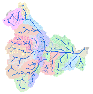

The hydrologic modeling tools provide methods for describing the physical components of a surface. The hydrologic tools allow you to identify sinks, determine flow direction, calculate flow accumulation, delineate watersheds, and create stream networks. The image below is of a resulting stream network derived from an elevation model:
Using an elevation raster or digital elevation model (DEM) as input, it is possible to automatically delineate a drainage system and quantify the characteristics of the system. The following graphics illustrate the steps involved in calculating a watershed and stream network from a DEM.
