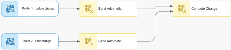

Raster function template
A raster function template is similar to a model because it contains processing steps that are joined together to perform a more complex workflow. A raster function template can contain one or more raster functions, and inputs to the raster functions can be set as variables, allowing users to plug in different values when they run the raster function template.
The raster function template below illustrates a methodology for describing burn severity and the health of vegetation recovery, using prefire and postfire imagery. The appropriate functions are placed in the editor and are interactively connected in which the output from one function is the input to the next function in the processing chain.
Raster function template in the editor
