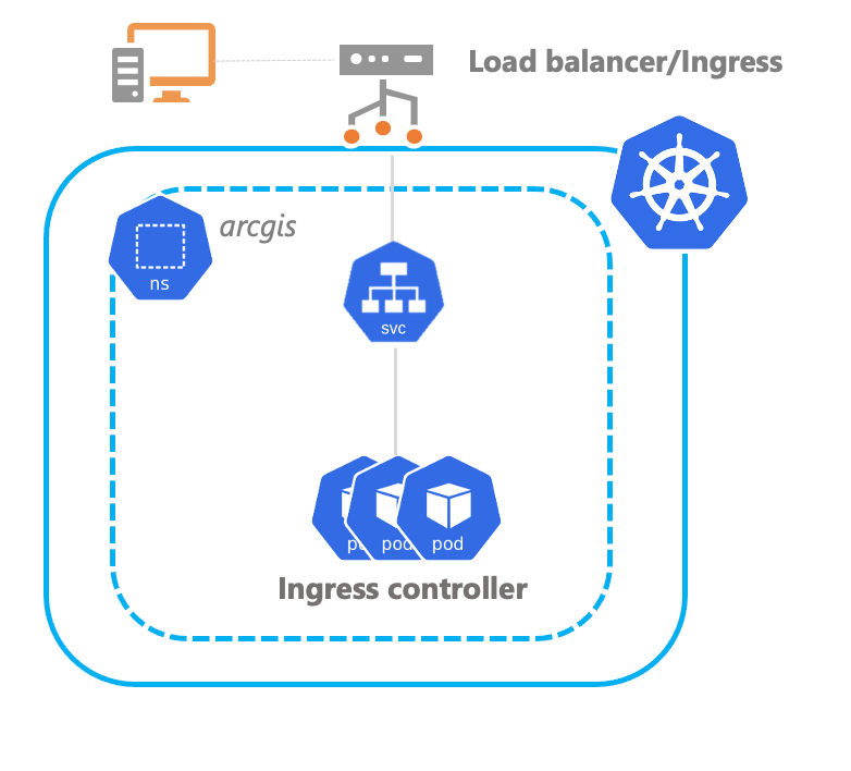

Network flow
The organization URL includes the FQDN used to direct client traffic to an ArcGIS Enterprise organization. The FQDN is resolved via a DNS record to an edge load balancer that routes traffic back to the bundled ingress controller. Between those two network hops, additional load balancers, instances of Web Adaptor, or ingress controllers can exist and affect the network flow. However, once the request reaches the bundled ingress controller, a set of managed and namespaced ingress objects is used to direct requests to the correct backend microservice.
If you are using a layer 7 load balancer at any point in the network path, you must set the X-Forwarded-Host header to match the FQDN of the organization for proper routing of the proxied requests and ensure they persist all the way back to the bundled ingress controller.
Network flow
