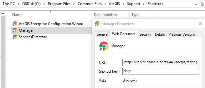

  1. In the Windows Start menu on the federated server, right-click the ArcGIS Server Manager shortcut, click More, and click Open file location.
  2. In the File Explorer window that opens, right-click the ArcGIS Server Manager shortcut item and again select Open file location.
    This opens the shortcut link in the folder C:\Program Files\Common Files\ArcGIS\Support\Shortcuts.
  3. Cut the Manager shortcut item and paste it to your desktop.
    The Manager shortcut item is now deleted from its original location.
  4. Right-click the pasted item, open Properties, and modify the URL property so that the URL uses HTTPS and the 6443 port to connect.
    For example, the URL should look similar to the following: https://gisserver.example.com:6443/arcgis/manager, where gisserver.example.com is the fully qualified domain name of one of the machines in the ArcGIS Server site.
  5. Click OK to apply the change and close the properties window.
  6. Cut the modified shortcut item and paste it back to the C:\Program Files\Common Files\ArcGIS\Support\Shortcuts folder.
    Screenshot of file location
The shortcut item will now open ArcGIS Server Manager from the Windows Start menu.
