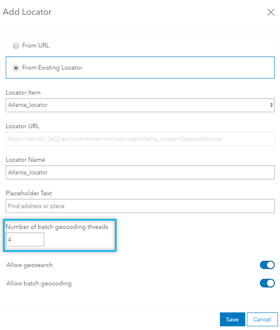

Configure the suggested number of batch geocoding threads for your locator
Any locator published to your portal can also be used by the GeocodingTools geoprocessing service running on your federated GIS Server site. The geoprocessing service can send multiple concurrent requests to the geocoding utility service to speed up the overall execution for batch geocoding. The number of concurrent requests (number of batch geocoding threads) made by the geoprocessing service can be configured by a portal administrator. It is important to set the number of batch geocoding threads to the correct value; otherwise, it will result in increased failures for batch geocoding.
As a best practice, the number of batch geocoding threads should be set proportionally to the number of instances available for the geocode service. For example, if there are eight instances available for the geocode service and the ArcGIS Server machine is only being used for batch geocoding, set the number of batch geocoding threads to 8. When the geoprocessing service is executed, it sends eight concurrent batch geocoding requests to the locator service. In case more instances are available for the locator service, adjust the number of batch geocoding threads appropriately to maximize the utilization of instances for the locator service. However, if two users want to batch geocode at the same time against the same service, the administrator should set the number of batch geocoding threads to 4, so each user is using half of the available geocode service instances, and the back-end geocode service is not overwhelmed with requests.
Note that the ArcGIS World Geocoding Service cannot be configured with batch geocoding threads. The following configuration applies to all other published locators that are configured as utility services.
To set the suggested number of batch geocoding threads for your locator, follow these steps:
  1. Publish the desired locator to your portal using ArcGIS Pro.
  2. Sign in to your portal as an administrator.
  3. Click Content, and make sure the locator is shared with the organization.
  4. Click Organization, and under Settings, browse to Utility Services.
  5. Scroll down to the Geocoding section, and click Add Locator. Select the locator you want to configure for batch geocoding, and adjust the Number of batch geocoding threads value.
  6. Click OK and click Save.

Note:
The number of batch geocoding threads must be less than or equal to the number of instances available for the locator. If a greater value is selected, batch geocoding jobs may fail.
