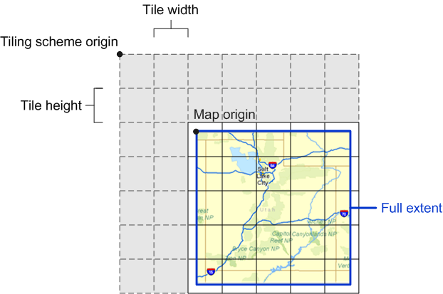

Tiling scheme
A tiling scheme establishes how clients should reference the tiles in a cache and is a mapping between the spatial reference of the source map document and the tiling grid.
The tiling grid uses a level of detail (scale), row, and column reference scheme. The scheme also defines the scale levels (level of detail) at which the cache has tiles, the size of the tiles in a pixel, and the screen resolution at which the tiles are intended to be most commonly displayed.
A tiling scheme is necessary to generate a map cache. By default, the tiling origin starts at the upper left of the coordinate system used by the service's source map document.
The tiling scheme properties define where tile boundaries exist.

Tile origin
The tiling scheme origin is the upper left corner of the tiling scheme grid. The origin does not necessarily represent the coordinate point at which tiles begin to be created. Instead, using a common tiling scheme origin ensures caches properly overlay one another in web apps.
In most cases, it is recommended that you keep the default tiling scheme origin suggested by the software. The default is the upper left point of the coordinate reference defined by the map document. If no coordinate reference is defined in the map document, the upper left point of two times the union of extents of all the layers in the map is used.
If you change the tiling scheme origin to something other than the default, be aware that tiles can be created only in the map area to the lower right of the tiling scheme origin. If you want to cache only a certain area of your map, creating tiles based on a feature class boundary is recommended instead of changing the tiling scheme origin.

Tile height and tile width
The default tile width and height is 256 pixels. It's recommended that you use 256 or 512. If you're building a cache that overlays another cache, be sure to use the same tile width and height for both caches.
Choosing a smaller tile width and height may improve performance of the application requesting tiles from the cache, as less data needs to be transferred per tile, but the number of tiles requested is increased.
