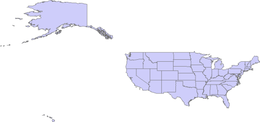

GetMap
Request
http://sampleserver1.arcgisonline.com/ArcGIS/services/Specialty/ESRI_StatesCitiesRivers_USA/MapServer/WMSServer?version=1.3.0&request=GetMap&CRS=CRS:84&bbox=-178.217598,18.924782,-66.969271,71.406235&width=760&height=360&layers=0&styles=default&format=image/png
Response map
WMS GetMap response map
