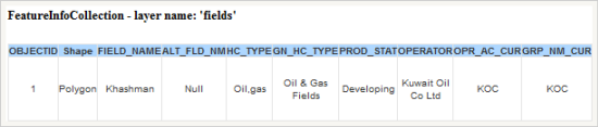

WMS services support a series of operations, such as GetCapabilities, GetMap, GetStyles, and so on, which allow client applications to work with the service by appending parameters to the service's URL. The GetFeatureInfo operation works in the same manner and is designed to return the attributes of features queried in a map in various formats such as HTML, XML, and plain text.
For example, the following is a GetFeatureInfo request along with its response in the default HTML format:
Request
http://gisserver.example.com/arcgis/services/ihs_petroleum/MapServer/WMSServer?&service=WMS&version=1.1.0&request=GetFeatureInfo&layers=fields&query_layers=fields&styles=&bbox=47.130647,8.931116,48.604188,29.54223&srs=EPSG:4326&feature_count=10&x=562&y=193&height=445&width=1073&info_format=text/html&
Response
Default HTML GetFeatureInfo response
In many cases, the default HTML, XML, or plain text response is appropriate, but there may be a situation when you want to customize the response format or schema to execute specific business logic. For example, for interoperability reasons, you might want to get the feature information back in a standard schema such as GML or GeoJSON.

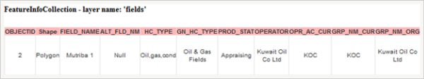

Example response
HTML GetFeatureInfo response with red table caption
However, if you decide to modify these templates, it will directly affect any WMS published through ArcGIS Server. For this reason, avoid trying to put any map service-specific logic into the templates.

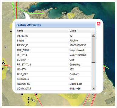

The template was created to make the WMS return its GetFeatureInfo responses in plain text GeoJSON with feature geometry instead of the default HTML format. GeoJSON can be parsed by many JavaScript libraries, allowing you to integrate your responses with web pages in an easy-to-read format.
Below is an example of a GetFeatureInfo GeoJSON response as a data source of an Ext.Grid in an OpenLayers web map application:

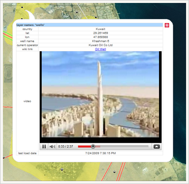

Below is an example of the GetFeatureInfo response with an embedded video in an OpenLayers web map application:
The following is a more comprehensive example that heavily customizes the GetFeatureInfo response to embed a JavaScript code snippet. The code plays a tour in the Google Earth plug-in web application. Keep in mind that in this XSLT template, there is logic specific to a particular WMS service. Therefore, this template should always be referenced through the xsl_template parameter. It should not be made the default template.

                <xsl:if test="$fieldName = 'PLOT_SYMBOL_GROUP'">
                  <xsl:choose>
                    <xsl:when test="$fieldValue = 14">
                        <td>
                          3d map
                        </td>
                        <td>
                          <div id="map3d" style="width:384px;height:256px;"></div>
                          <script type="text/javascript">
                            google.earth.createInstance(
                              'map3d',
                              function(instance) {
                                ge = instance;
                                ge.getWindow().setVisibility(true);
                                var kmlStr = ''
                                  + '<kml xmlns="http://www.opengis.net/kml/2.2" xmlns:gx="http://www.google.com/kml/ext/2.2">'
                                  + '<gx:Tour>'
                                  + '<gx:Playlist><gx:FlyTo>'
                                  + '<gx:duration>20.0</gx:duration>'
                                  + '<LookAt>'
                                  + '<longitude>' + popup_lon + '</longitude>'
                                  + '<latitude>' + popup_lat + '</latitude>'
                                  + '<altitude>0</altitude>'
                                  + '<heading>0</heading>'
                                  + '<tilt>0</tilt>'
                                  + '<range>500</range>'
                                  + '<altitudeMode>relativeToGround</altitudeMode>'
                                  + '</LookAt>'
                                  + '</gx:FlyTo></gx:Playlist>'
                                  + '</gx:Tour>'
                                  + '</kml>';
                                var kmlObj = ge.parseKml(kmlStr);
                                ge.getTourPlayer().setTour(kmlObj);
                                ge.getTourPlayer().play();
                              function() {
                          </script>
                        </td>
                    </xsl:when>
                  </xsl:choose>
                </xsl:if>
