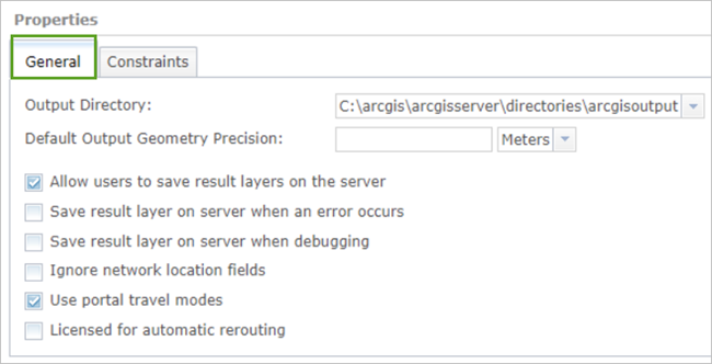

General
The following properties are available on the General tab and will be applied to all the solvers when selected:
General tab
  • Output Directory—Specify the location where the result layers are written.
  • Default Output Geometry Precision—Specify by how much you want to simplify the output geometry returned by the service. If it is set to zero or not specified, no generalization of output geometry is performed. If it is specified and positive, it reduces the overall response size and also improves the performance for drawing the shapes in the applications.
  • Allow users to save result layers on the server—Specify whether users can save result layers on the server for future use.
  • Save result layer on server when an error occurs—Specify whether result layers are automatically saved in the output directory if there is an error during analysis. If selected, this option may aid in troubleshooting an error.
  • Save result layer on server when debugging—When this box is checked, result layers are automatically saved in the output directory for every request if the log level is set to DEBUG.
  • Ignore network location fields—If this setting is checked, the service will not use the location fields on the input analysis locations (stops, barriers, facilities, incidents, and so on) if they are passed in with the request. It is useful to ignore network location fields if street names change often to avoid passing in requests with stale location fields.
  • Use portal travel modes—If this setting is checked, the service will use the travel modes configured in ArcGIS Enterprise instead of the travel modes defined on the network dataset used by the service.
  • Licensed for automatic rerouting—If this setting is checked, client applications, such as those built using the Navigation API in ArcGIS Maps SDKs for Native Apps, are notified that the service can be used for rerouting.

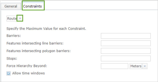

Constraints
Constraints are a set of properties that can be defined for each solver to enable or disable capabilities or to limit the size of the problems that can be solved by the service. These properties can be set on the Constraints tab. You can select the solver type using the drop-down menu.
Constraints tab
The following constraints are available for each solver:
  • Max Barriers—The maximum number of point barriers allowed to pass in per request.
  • Max Features intersecting line barriers—The maximum number of streets that can be restricted by line barriers per request.
  • Max Features intersecting polygon barriers—The maximum number of streets that can be restricted by polygon barriers per request.
  • Force Hierarchy Beyond (Extent of Inputs) and Units of Force Hierarchy Beyond (Extent of Inputs)—When stops are a great distance apart, solving requests can require a lot of time and server resources if these options are not selected.
