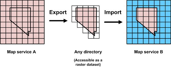

Import and export scenario for cache tiles
Cache tiles can be exported for access as raster datasets and, optionally, imported into other caches.
Cache tiles can also be exported to be accessed as raster datasets and imported into other caches.
