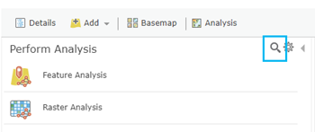

  1. From the map view, click the Analysis button to open the Perform Analysis pane.
    On the Perform Analysis pane, two choices are presented for the type of analysis to perform, Feature Analysis and Raster Analysis. These two categories contain standard system tools for processing your feature data and imagery. Note that raster function templates are designed to work with imagery and will not process feature data.
  2. Click the Search button to browse to your raster function templates.

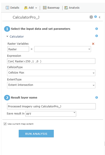

    The Analysis pane shows the user interface for the raster function template. Under Select the input data and set parameters, the template is organized based on the component function followed by its parameters. In the example below, Calculator is the only function in this template. This section is collapsible and contains inputs for raster variables, the expression, cell size, and extent type.
    Raster function parameters dialog box
  5. Under Result layer name, give the output layer a name and designate the folder where you want it saved.
    The last option in the raster function parameter pane is Use current map extent. Check this box to process only the portion of your imagery visible in your map view. Uncheck this box and the entire image will be processed.
