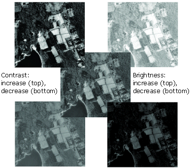

The Contrast And Brightness function enhances the appearance of raster data by modifying the brightness and contrast within the image. Brightness increases the overall lightness of the image—for example, making dark colors lighter and light colors whiter—while contrast adjusts the difference between the darkest and lightest colors. Below is an example of adjustments made to the brightness and contrast of an image.
Brightness and contrast example
