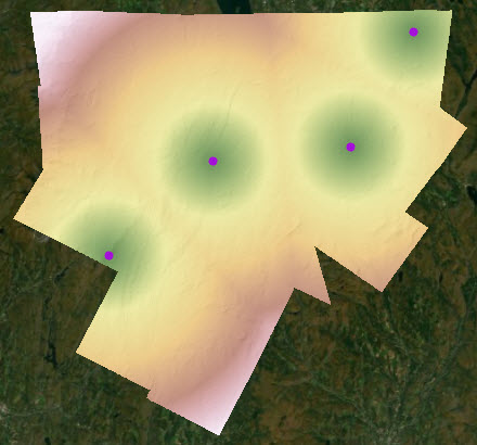

Determining how far away one thing is from another is the basic element of calculating distance. It is the straight-line or Euclidean distance between two points. For additional information, see Calculate straight-line distance.
Map of straight line distance calculated from four points
Straight-line distance is calculated from each cell to the closest electrical substation (purple points). The distance is measured in linear units.
However, there are other factors that can alter the straight-line distance calculation including barriers and surface distance.

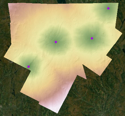

For each cell, a cost surface identifies how the features at the location affect the movement through the cell. It is the cost to the traveler to move through the location. The lower the defined cost for a cell, the easier the movement. For example, a hiker can move quickly and easily through an open field, but muddy ground in a thick forest will slow them down, making them use more energy and it will take longer to travel each distance unit. For use cases and additional information about how the cost surface affects how distances are encountered, see Adjust the encountered distance using a cost surface.
Map of accumulative cost distance calculated from four points
Accumulative cost distance is calculated from each cell to the cheapest electrical substation (purple points) over a cost surface.
The distance is measured as a rate of cost. Because of the cost surface, the cost distances do not radiate equally from each source as they do in the straight-line distance result.
