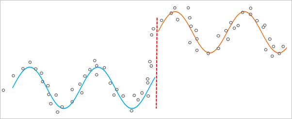

The CCDC algorithm identifies all three change types with the primary purpose of identifying abrupt change. Harmonic regression and trend models are fitted to the data to estimate seasonal and gradual change, and sudden deviations from the trend models are indications of abrupt change.

The seasonal and gradual changes that occur for pixel values over time are modeled for each band in the imagery using the ordinary least squares (OLS) method. The difference between the predicted, modeled pixel value and the true pixel value is calculated. When the difference between the values is three times greater than the root mean square error (RMSE), that pixel is flagged as a possibility for land cover change.
Potential land cover change is then assessed for true change based on the number of consecutive observations. If a pixel's value is markedly different from the model results only once, this is likely an outlier. If the pixel's value is markedly different from the model results for a given number of consecutive observations, the algorithm considers that pixel to have changed. The minimum number of consecutive observations can be controlled in the Analyze Changes Using CCDC tool with the Minimum Consecutive Anomaly Observations parameter.
Abrupt change in pixel values over time, accounting for seasonality
