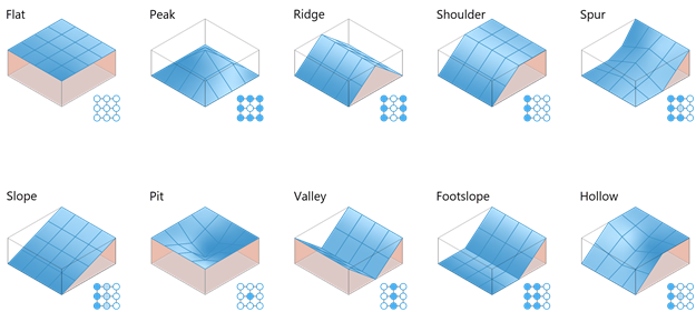

Match geomorphon pattern to landform type
The tool uses the lookup table to match a geomorphon pattern to a specific landform type, following the arguments presented in Jasiewicz and Stepinski (2013). The table matches a geomorphon pattern to one of the 10 most common landforms.
Ten most common landform types
Figure 3. The 10 most common landform types.
More than one different geomorphon pattern can be matched to a specific landform if there is little variation in their definition. The acceptable variation is a necessary assumption to create the lookup table.
Look up table to match a geomorphon pattern to one landform type
Figure 4. Look up table matching a geomorphon pattern to one of the 10 most common landform types. Each axis shows the total number of (1) or (-1) values present in the pattern.
Only Peak and Pit landform types are matched to a unique geomorphon pattern. For Peak landform type (-1, -1, -1, -1, -1, -1, -1, -1) essentially all cells surrounding the target cell are lower. Similarly for Pit landform type (1, 1, 1, 1, 1, 1, 1, 1) essentially all cells surrounding the target cell are higher.
