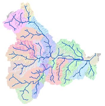

The hydrologic modeling tools provide methods for describing the physical components of a surface. The hydrologic tools allow you to identify sinks, determine flow direction, calculate flow accumulation, delineate watersheds, and create stream networks. The image below is of a resulting stream network derived from an elevation model:
Example stream network derived from elevation model
