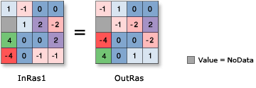

Changes the sign (multiplies by -1) of the pixel values of the input raster on a pixel-by-pixel basis.
Negate illustration
Notes
If the input is an integer, the output raster will be an integer type. If the input is floating point, the output raster will be a floating-point type.
If the input is a multiband raster, the output will be a multiband raster. The function will perform the operation on each band in the input.
