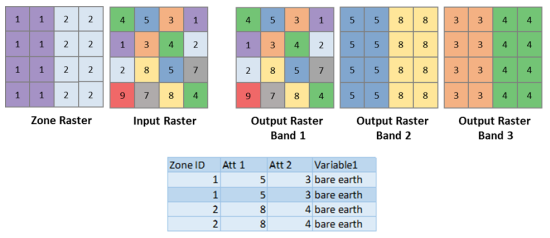

The Rasterize Attributes function enriches a raster by adding bands derived from values of specified attributes, from an external table, or from a feature service.
You can optionally specify a zone raster and the associated zone ID attribute to enable regional lookups.
Zone raster, input raster, output band 1, output band 2, output band 3, and a zonal attributes table

An optional single-band raster where each pixel contains the zone ID associated with the location. The zone ID is used for looking up rows in the zonal attributes table for zone-specific ingestion.

A list of fields in the Zonal Attributes Table, where each field is separated by a comma. Values in each field will be represented by a band in the output raster.

If you were using the table above as an example, the query would be Variable1 = 'bare earth'.
