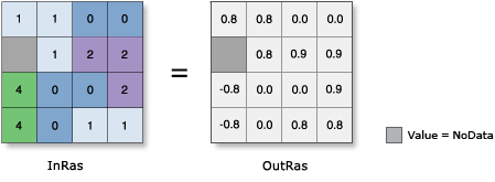

Calculates the sine of the pixels in a raster.
Notes
In mathematics, all trigonometric functions have a defined range of valid input values, called the domain. The output values from each function also have a defined range. For this tool, the domain and range are as follows:
Domain: -∞ < [in_value] < ∞
Range: -1 ≤ [out_value] ≤ 1
Note that here -∞ and ∞ represent the smallest negative and largest positive values supported by the particular raster format, respectively.
The input values to this tool are in radians. If degrees are desired, the resulting raster must be multiplied by the radians-to-degrees conversion factor of 180/\(\pi\), or approximately 57.296.
The output raster is always a floating-point type, regardless of the input value type.
The output values from this tool are interpreted as unitless.
If the input is a multiband raster, the output will be a multiband raster. The function will perform the operation on each band in the input.
If the input is a multidimensional raster, all slices from all variables will be processed, and the output will be a multidimensional raster.
Due to the range of values, applying a linear stretch renderer can be useful to better see the results.
