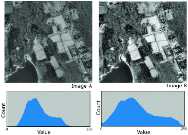

The following images show an example of a stretch. Histogram A represents the pixel values in image A. By stretching the values (shown in histogram B) across the entire range, you can alter and visually enhance the appearance of the image (image B).

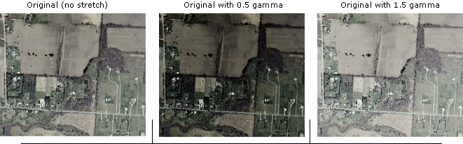

Gamma refers to the degree of contrast between the midlevel gray values of a raster dataset. Gamma does not affect the black or white values in a raster dataset, only the middle values. By applying a gamma correction, you can control the overall brightness of a raster dataset. Additionally, gamma changes not only the brightness but also the ratios of red to green to blue.
Gamma values less than one decrease the contrast in the darker areas and increase the contrast in the lighter areas. This darkens the image without saturating the dark or light areas of the image. This helps bring out details in lighter features, such as building tops. Conversely, gamma values greater than one increase the contrast in darker areas, such as shadows from buildings. Gamma values greater than one can also help bring out details in lower elevation areas when working with elevation data.
In the following images, you can see the effect of adjusting the gamma values used to display a raster dataset:
