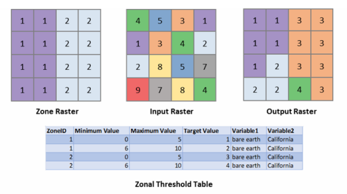

This function allows you to remap pixels in a raster according to zones defined in another raster, or zone-dependent values defined in a table.
The zone raster, a sample input raster, the output raster, and a zonal threshold table

If you were using the table above as an example, the query would be Variable1 = 'bare earth' AND Variable2 = 'California'.
