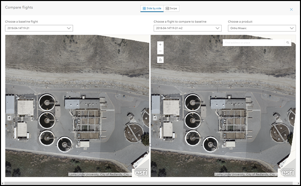

Open a project with at least two flights. On the flight management page, click Compare. The Compare flights page appears, displaying a similar product from the two flights in side-by-side mode. Select a flight from the drop-down list to display as the baseline flight, and, similarly, choose a flight to compare with the baseline flight. Select the product you want to compare from the Choose a product drop-down list. The product is displayed in side-by-side mode.
Compare products from different flights.
The panels on the Compare flights page are geographically linked. Both the baseline image and the comparison image are synchronized as you pan and zoom in either panel. You can type an address or place in the location search window, and the location will be centered in the display.
Click Swipe to display the products from the different flights in swipe mode. The two products are overlaid in one display panel, and compared using the swipe bar.
