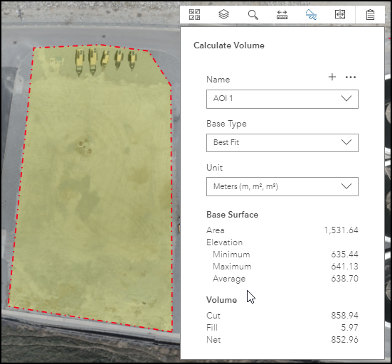

Define the AOI on a map
To perform cut-and-fill volume calculation by defining an AOI on a map, complete the following steps:
  1. Click the Calculate Volume map tool on the toolbar.
  2. In the area of interest dialog box, click Define.
  3. Define your AOI on the map using the mouse. Double-click to complete your polygon AOI.
    The Area of Interest pop-up appears for the newly created AOI.
  4. Do the following in the Area of Interest pop-up:
    1. Provide a name.
    2. Set the digital elevation in Base Type.
    3. Click Apply.
    The area and volume calculations appear on the map tool. If you change Base Type and Unit, the calculation updates automatically.
  5. Optionally click the Add button and repeat the steps above to define additional AOIs.
  6. Optionally click the AOI drop-down list, select an AOI, and click Delete to remove an AOI.
  7. Optionally click Options and click Report to view a report for all the AOIs.
    You can copy the content to other applications on the Volume Report dialog box.
  8. Optionally click Options , and click Export to export AOIs to a local file.
    The AOIs are saved in your project.
