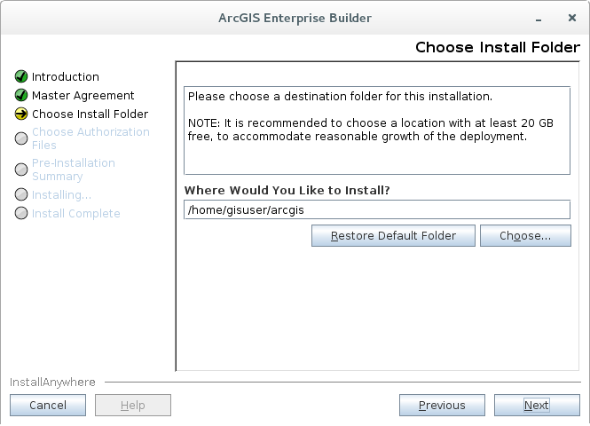

  8. On the Choose Install Folder dialog box, provide the installation location for ArcGIS Enterprise Builder.
    All components will be installed to subdirectories at this specified location. The default location is your home directory.
    Portal for ArcGIS database services use a directory to store user-generated content, as well as the default content initially installed. The content will remain on the machine after ArcGIS Enterprise Builder has been uninstalled, enabling subsequent Portal for ArcGIS installations to use existing content. A content directory will be created at <Install Folder>/usr/arcgisportal (for example, /home/gisuser/arcgis/usr/arcgisportal).
    An installation folder must be specified for the installation of ArcGIS Enterprise Builder components.
    Note:
    You cannot install ArcGIS Enterprise Builder on a shared network directory (NFS mounted folder). The directory must be local on the target system.

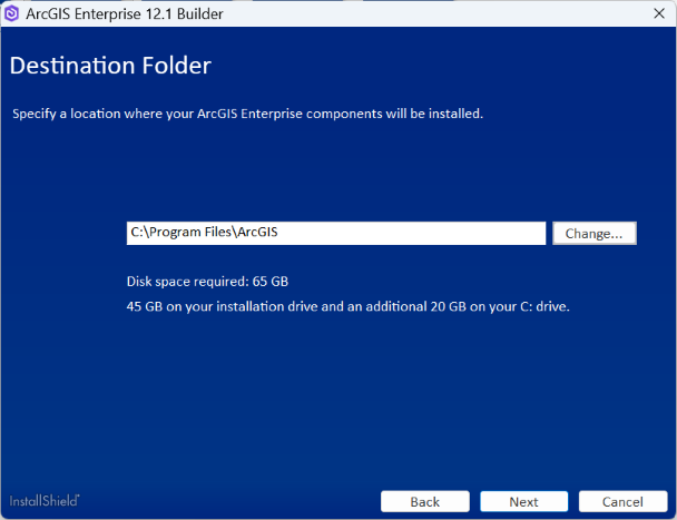

  9. Provide the installation location for ArcGIS Enterprise Builder.
    The default location is C:\Program Files\ArcGIS. All components of ArcGIS Enterprise will be installed to subdirectories at this location. Portal for ArcGIS and Portal for ArcGIS Web Styles will be installed to \ArcGIS\Portal, ArcGIS Server will be installed to \ArcGIS\Server, and ArcGIS Data Store will be installed to \ArcGIS\DataStore.
    Portal for ArcGIS database services use a directory to store user-generated content, as well as the default content initially installed. The content will remain on the machine after ArcGIS Enterprise Builder has been uninstalled, enabling subsequent Portal for ArcGIS installations to use existing content. A content directory will also be created at this root location (such as C:\arcgis\arcgisportal.)

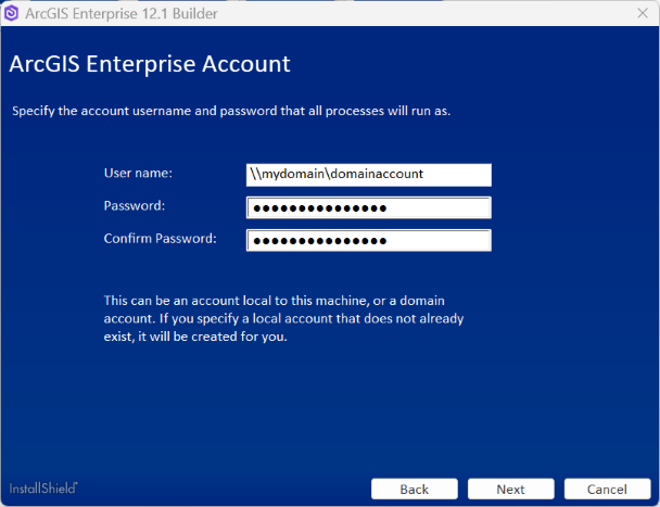

  10. You can directly specify the account name and password to run your ArcGIS Enterprise services. The same account will be used to run all these services. The account used can be a local or domain account. The account you specify does not have to be part of the Administrators group. If you use a local operating system account, the account is created for you if it does not already exist. The default account name is arcgis.
    Specify the account user name and password that all processes will run as.
    If you enter a domain account, it must already exist on the domain and must be entered using the following format:
    If you enter a domain account, it must already exist.
    If the account you specified already exists, the password you enter must be correct or the installation will immediately return an error indicating an incorrect password. If a domain account is specified and does not exist, the installation will immediately return an error.

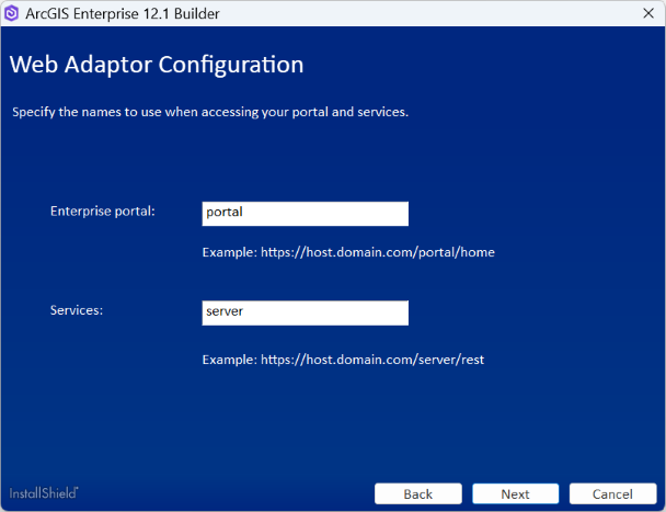

  11. The ArcGIS Enterprise Builder setup will create an ArcGIS Web Adaptor (IIS) for your hosting server and portal. Accept the default names for these ArcGIS Web Adaptors, or provide different ones.
    Provide unique Web Adaptor names or accept the defaults.

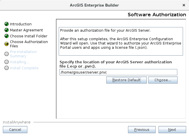

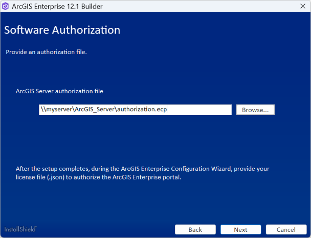

  12. Authorize the software for use.
    An installation of ArcGIS Enterprise Builder requires a valid authorization file (.ecp or .prvc) for ArcGIS Server Standard or Advanced and a valid license file (.json) for Portal for ArcGIS. You need to have both of these files before installing. See Prepare to install ArcGIS Enterprise Builder for more information.
    On the Software Authorization dialog box, provide the location of your ArcGIS Server authorization file.
    Specify the location for your ArcGIS Server authorization file.
    Provide the location of your ArcGIS Server authorization file.
    Provide the location for your ArcGIS Server authorization file.
    Note:
    The .prvc authorization file must have all user information completed before specifying it in the setup program. Open the authorization file in a text editor, and complete the User Information section.
    After the software setup completes, in the ArcGIS Enterprise Configuration Wizard, you will provide your license file (.json) to authorize Portal for ArcGIS.
