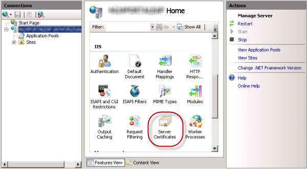

  1. In the Connections pane, select your server in the tree view and double-click Server Certificates.
    Server Certificates icon in IIS Manager

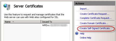

  2. In the Actions pane, click Create Self-Signed Certificate.
    Create Self-Signed Certificate link in IIS Manager
