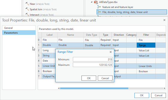

Parameter filters
When authoring a tool, you can set a filter on the Parameters tab of the Tool Properties dialog box. Only filters for supported input data types are supported, other than Date filters, or the value list filters for number data types such as Long and Double.
Example
In the tool below, a Double parameter has a range filter with a minimum value of 213 and a maximum value of 123132.123.
Setting a parameter's range filter

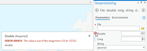

When the tool has been published and used as a web tool in ArcGIS Pro, an input value outside of the filter range prompts an error indicating the value is out of range.
The use of a range filter prevents values from being used outside of your defined range.
