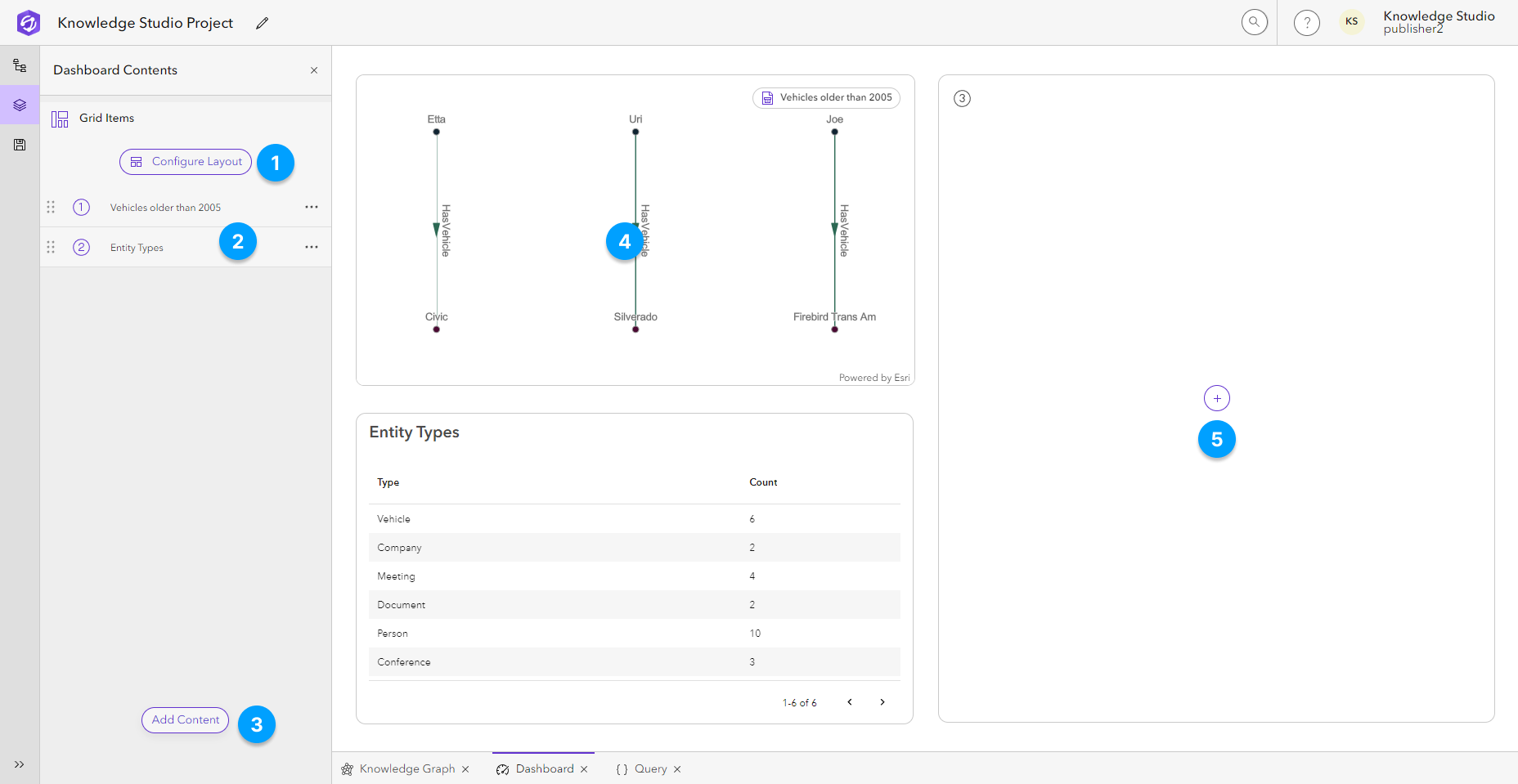

You can select different layouts (number 1 in the image below) for your dashboard that contain one to four card slots. Cards added to the dashboard are listed in the Dashboard contents (number 2 in the image below). Reordering the cards listed in the contents will reorder them in the layout. You can add content to your dashboard (number 3 in the image below) and display in an available card in the layout (number 4 in the image below). You can also add content directly to an empty card (number 5 in the image below)
Dashboard diagram
