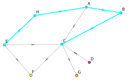

For example, in the graph below, if the origin is the entity E, the destination is the entity C, and the entity B is defined as a mandatory waypoint, the shortest path is the one defined by the highlighted entities and relationships: from E to H to A to B to C. Each entity and relationship is traversed only once and the waypoint filter is satisfied.
The shortest path between entities E and C that includes entity B is the one highlighted on the graph.
