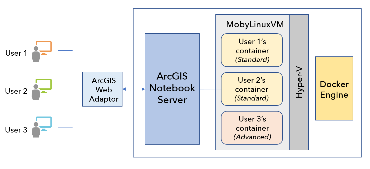

In Windows deployments of ArcGIS Notebook Server, notebook containers are hosted on the machine within a Linux virtual machine (MobyLinuxVM) running in the Microsoft Hyper-V virtualization server. This Linux virtual machine governs the resource limits available for use by the containers.
Windows ArcGIS Notebook Server architecture
