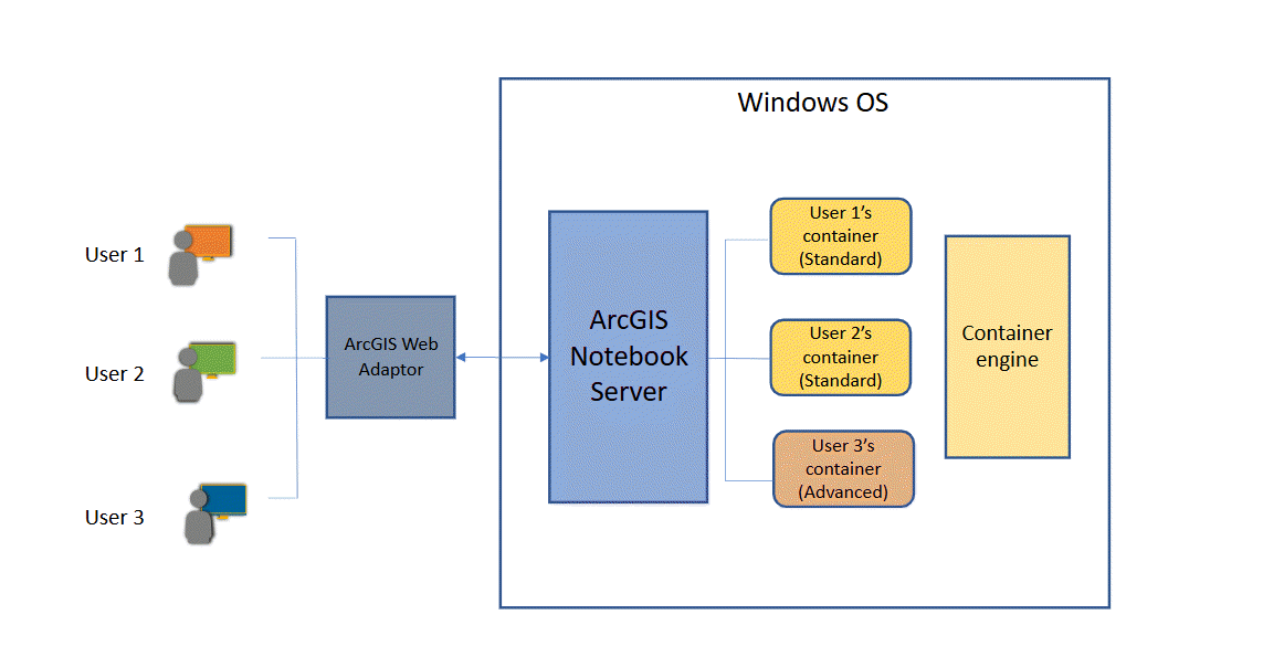

Similar to other ArcGIS Notebook Server deployments, ArcGIS Notebook Server with Windows containers is installed on a server operating system and is configured and federated with an ArcGIS Enterprise portal. Additionally, a web adaptor can be deployed in front of the ArcGIS Notebook Server software.
ArcGIS Notebook Server uses virtualized operating systems known as containers to isolate notebook authors' environments. As a result, the containers allow each author to use a subset of server resources without their work or resource usage interfering with others.
These containers are allocated and maintained by a third-party container engine, either Mirantis Container Runtime or Docker Engine from binaries. Before installing ArcGIS Notebook Server, you must install a container engine. Once ArcGIS Notebook Server is installed, it must be configured to work with that container engine.
ArcGIS Notebook Server allocates one container per runtime to each notebook author on the site, and only they can work in the container. The computing resources the authors use when running notebooks will not affect other authors' containers.
When a portal member with corresponding privileges opens their first notebook, a container is launched on the ArcGIS Notebook Server site. This session between the notebook and the container will be ongoing through the duration of the notebook.
ArcGIS Notebook Server can join multiple machines together in a site. Machines in a multiple-machine configuration must be configured to be identical, and each machine can run ArcGIS Notebooks.

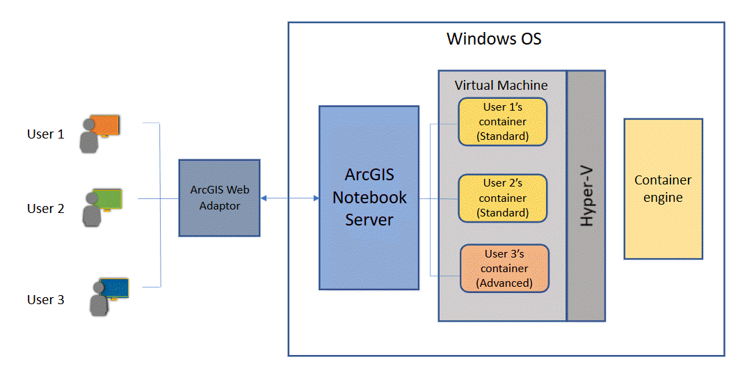

The Windows containers in an ArcGIS Notebook Server site support two modes of runtime isolation, process and Hyper-V. See the Microsoft Isolation Modes documentation for more information on the modes. If you configure your site to use Hyper-V isolation, the Hyper-V role must be installed on the machine. See the Microsoft documentation for more information on how to install Hyper-V for Windows Server.
Note:
There are limitations with respect to the number of containers that can be run when using Windows containers with Hyper-V. See Microsoft Frequently asked questions about containers for more information.

When a container is launched, the Windows container image provided by Esri is applied to the container. The runtime will depend on the license configured for ArcGIS Notebook Server and the notebook author's privilege.
