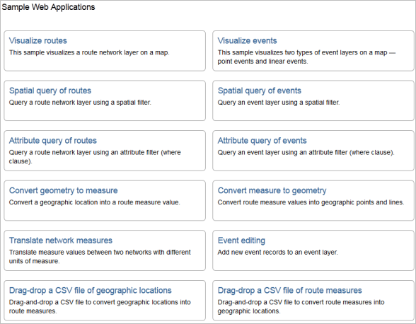

Included JavaScript web developer samples
Pipeline Referencing includes ArcGIS Pipeline Referencing sample web apps that demonstrate the use of available REST services.
REST API sample web apps
These developer samples demonstrate how a web or connected mobile developer can accomplish the following:
  • Visualize networks on a map.
  • Visualize events on a map.
  • Locate measures on a route.
  • Perform spatial and attribute queries for routes.
  • Perform spatial, measure, and attribute queries for events.
  • Convert routes and measures to coordinates.
  • Convert coordinates to routes and measures.
  • Convert measures between LRMs.
