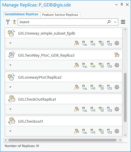

You can open the Manage Replicas pane from a geodatabase to view all replicas in the geodatabase. The image below shows the Manage Replicas pane opened from an enterprise geodatabase connection named P_GDB@gis.sde.

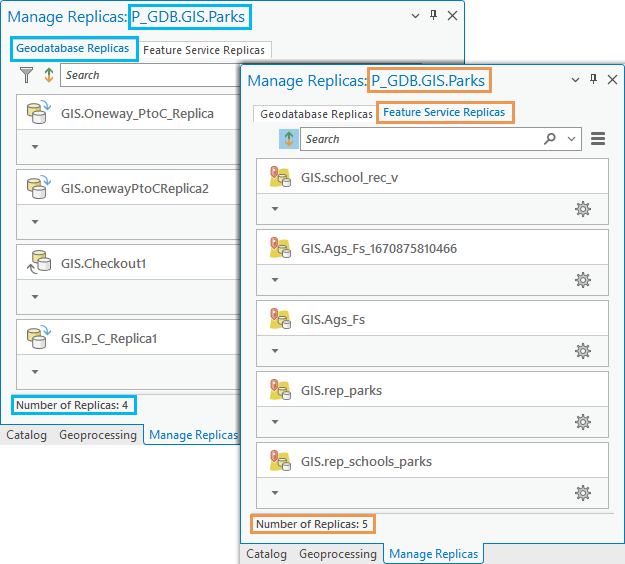

Alternatively, you can open the Manage Replicas pane from a feature class or table to see all the replicas the dataset participates in. The image below shows the Manage Replicas pane opened from the GIS.Parks feature class. The image shows lists of the geodatabase replicas and feature service replicas in which the GIS.Parks dataset participates.

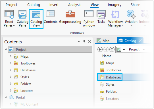

Follow the steps below to open the Manage Replicas pane for an enterprise geodatabase from the Catalog view in ArcGIS Pro:
Open a catalog view.
See Use catalog views for instructions.
Double-click Databases in the Catalog view and select or add a connection to an enterprise geodatabase.

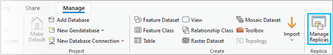

Once a database connection is selected, the contextual Manage tab becomes active.
Click the Manage Replicas button to open the Manage Replicas pane.

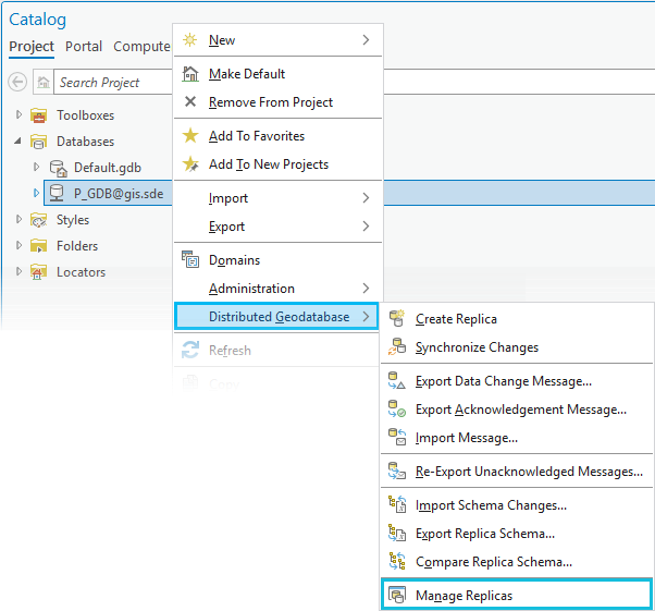

Use the Distributed Geodatabase context menu to view replicas for a geodatabase
Use the Distributed Geodatabase context menu in the Catalog pane in ArcGIS Pro to open the Manage Replicas pane for an enterprise geodatabase or a dataset.
In the Catalog pane, connect to the enterprise geodatabase.
Right-click the database connection, point to Distributed Geodatabase, and click Manage Replicas
The Manage Replicas pane appears.

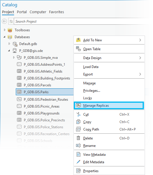

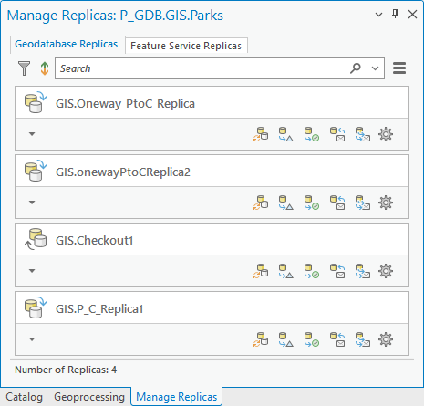

View replicas for a feature class or table
To see a list of replicas that a specific feature class or table belongs to, use these steps to open the Manage Replicas pane from the dataset context menu in ArcGIS Pro:
Expand the database connection, right-click a feature class or table, and click Manage Replicas
on the context menu.
This example shows the GIS.Parks feature class in the P_GDB geodatabase participates in four geodatabase replicas.
