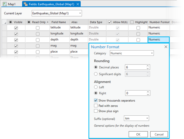

You can format a numeric field type to give additional context to an attribute so that it is more than a number. Numeric field formatting is a layer property that can be set only in the current map.
Numeric field formatting options
See Format numeric and date fields to learn how to apply numeric formatting to a field in a layer or stand-alone table.

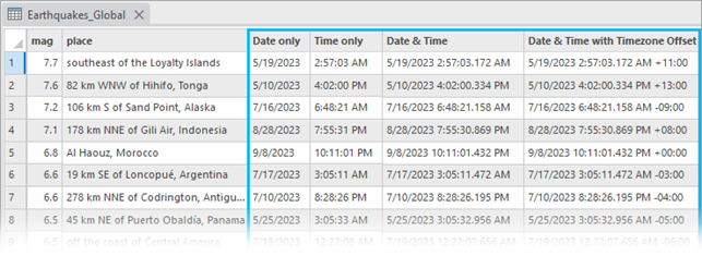

Date and time
Many datasets store date and time (temporal) information. Date and time values might represent when a feature was in a specific location or when a feature was first observed in the real world. Or the date and time might relate to other nonspatial attributes in the layer, such as when a property was sold, the last time a sample was taken from a specific water body, or the date and time a fire engine was dispatched from a specific fire station.
You can store temporal values in one of the following date or time data types:

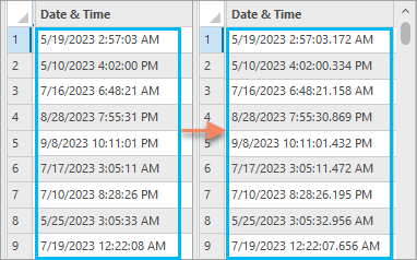

  • Date—Date and time value precision in seconds (low precision) or milliseconds (high precision).
    Tip:
    Beginning with ArcGIS Pro 3.2, you can migrate date fields in a table to high precision to support millisecond time.
  • Date only—Date values only with no time values
  • Time only—Time only values up to seconds only precision with no date values
  • Timestamp offset—Date, time, and offset from the Coordinated Universal Time (UTC) zone

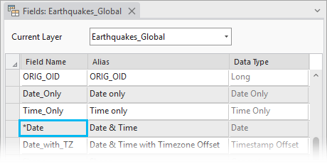

    Formatting display of date and time components
Caution:
ArcGIS Pro 3.1 and earlier cannot access geodatabase tables or feature classes that contain fields of the following data types: date only, time only, timestamp offset, big integer, or 64-bit object IDs. Although you can publish these data types to ArcGIS Enterprise 12.0, they are not fully supported and their use in ArcGIS Enterprise 12.0 web layers is considered beta functionality.
Some of the tools in which the date and time data types can be accessed include the fields view, the Add Field geoprocessing tool, the Create Feature Class wizard, and the Create Feature Class geoprocessing tool.
Date only, time only, and timestamp offset are new date and time fields. Existing date fields can be migrated to high precision to store time values with millisecond time.

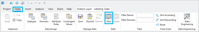

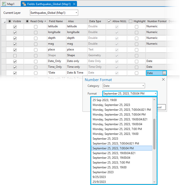

In ArcGIS Pro, you can view and manage these fields of a layer or table in the fields view. This allows you to model the attributes that are shared by a collection of features or objects in a table. In the fields view, you can edit the fields and their properties, delete fields, and create new ones.
Learn more about how to create, delete, and modify fields of a layer or table
Date and time data type options available from the fields view

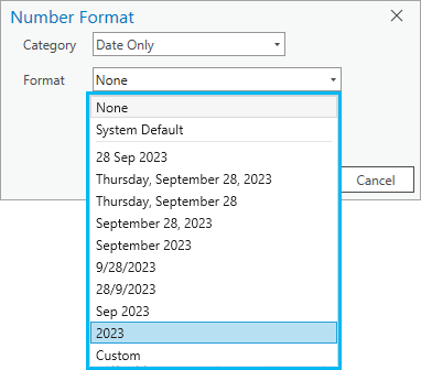

You can choose from multiple date formats to apply to the Date category. Applying formatting to a date or time field type helps provide additional context to and improve the readability of date and time values. Date field formatting is a layer property that can be set for layers in the current map only. See Format numeric and date fields to learn how to apply date formatting to a field in a layer or stand-alone table.
Date field formatting options

ArcGIS date and time field types summary
You can create or update a feature class or table with these new date and time field types in a file, mobile, and enterprise geodatabase. Some of the new date and time field types are not supported depending on the database used, and you might not be able to add some of the new date and time field types. When adding a field to a table or feature class, if the data type chosen is not supported for the workspace, you'll see the following error: The data type is not supported by the workspace. You must use a data type that is supported for the workspace.

Migrate date field to high precision
Use the Migrate Date Field To High Precision geoprocessing tool to migrate date fields in a table to high precision. High-precision date fields allow the time value in a date field to support fractional seconds up to the thousandths place or milliseconds and will display as MM/DD/YYYY hh:mm:ss.sss.
Date field migrated to high precision
Migrating the date field to high precision enables time values to support fractional seconds up to millisecond precision.
Caution:
  • ArcGIS Pro 3.1 and earlier clients cannot access geodatabase tables or feature classes that contain date fields that have been migrated to include millisecond time values.
  • Once a date field has been migrated to high precision, it cannot be undone on the field. To revert the date data back to a low-precision date, create a new date field (low precision), and use the Calculate Field geoprocessing tool to populate this new date field (low precision), from the high-precision date field.
In ArcGIS Pro, the asterisk (*) symbol indicates that a special property is associated with a particular field. Once you have migrated a date field to high precision, an asterisk will appear next to the high-precision date field name in the Fields view.
An asterisk appears next to the field name when the date field has been migrated to high precision.

Formatting options in ArcGIS Pro for the date only data type only change how the data values are displayed and does not affect how the data is stored or how the data can be entered. For example, the following image shows formatting examples for the date only data type.
ArcGIS Pro formatting options for the date only data type
See Format numeric and date fields to learn more.

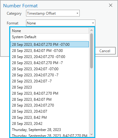

Formatting options in ArcGIS Pro for the timestamp offset data type only change how values are displayed; they do not affect how the values are stored or how values can be input. For example, the following image shows formatting examples for the timestamp offset data type.
ArcGIS Pro formatting options for the timestamp offset data type

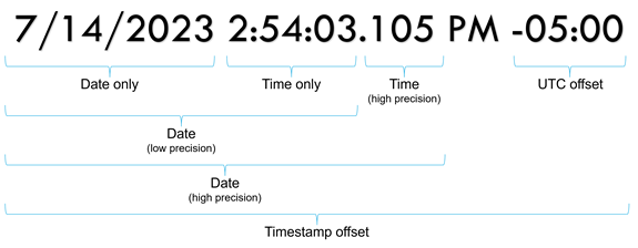

A global ID, GUID (Globally Unique Identifier), and UUID (Universally Unique Identifier) are all types of unique identifiers made up of 128 bits represented as a string of characters. While they are fundamentally the same in structure and purpose, their specific uses and management differ based on the context in which they are applied.
For example, global IDs are used explicitly in ArcGIS geodatabases and are automatically assigned and maintained by the geodatabase. GUIDs are a more general term and are broadly used across various systems, databases, and different programming environments, including Microsoft products, where developers can manually generate them if needed. Global IDs and GUIDs are based on and conform to the same underlying standard, the Universally Unique Identifier (UUID).
Global IDs
In ArcGIS Pro, a global ID is a type of Universally Unique Identifier (UUID) in which values are automatically assigned and managed by a geodatabase when a row or feature is created. Global IDs ensure that each row or feature in a table or dataset has a unique fingerprint that cannot be changed, providing a reliable method for maintaining data uniqueness within a single geodatabase and across multiple geodatabases.
Global IDs and GUID data types store a registry-style string of letters and numbers totaling 36 characters, or 128-bits. In all geodatabases, except those in Microsoft SQL Server, global IDs are stored in text fields, and the characters in a text global ID field are always uppercase and surrounded by curly brackets (for example, {C53E50CE-BA05-45C5-8E0C-A516B08E4201}).

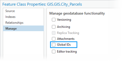

The GlobalID field data type is only supported in geodatabases and can be added to a table, feature class, or feature dataset in a geodatabase.

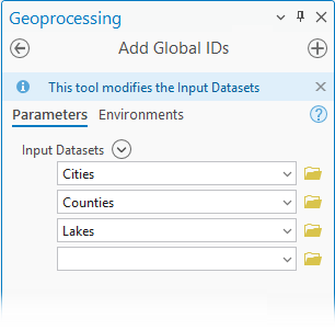

Use one of the following methods to add global IDs to your dataset:

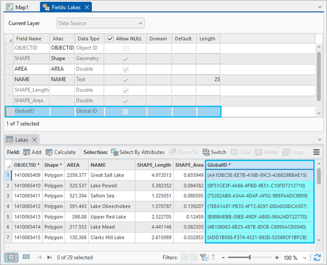

When global IDs are generated, the process considers both the device used and the creation time, resulting in an extremely low likelihood of duplicate values. After running the tool, you can verify that the GlobalID field has been added by opening the dataset's attribute table. You should see a new field named GlobalID with unique values for each row. Once the GlobalID field has been added to the dataset, the geodatabase will automatically generate and maintain these global ID values. For example, when a new feature is created in a dataset, a global ID value is automatically assigned to it.
The GlobalID field in the Fields view and GlobalID field values in the Table view

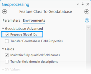

Some geoprocessing tasks, like the Append tool, have an environment setting option to preserve Global IDs when appending data. In this scenario, when checked, the Preserve Global IDs environment setting will reuse the global ID values of the existing input dataset when appending rows to a target dataset.
Preserve Global IDs Environments setting
Learn more about the Preserve Global IDs environment setting.

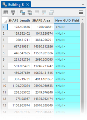

In ArcGIS, you can also create and use other GUID fields. GUID fields in a geodatabase are fields that can store global IDs. GUID fields inherently hold the same type of 36-character values as global IDs, except that GUID fields are empty, and you must manually populate and maintain these GUID field values. This also means that a GUID field can be deleted, edited, and renamed, unlike the global ID field.
Newly added GUID field
One or more GUID fields can be added to geodatabase datasets using various methods, including using the fields view or from the Fields tab, click the New button in the Edits group to add a new field.
Fields tab
Learn more about creating and managing fields or access this technical article on populating a GUID field with values from a text field in ArcGIS Pro.

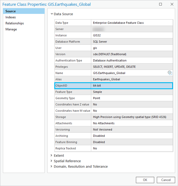

To determine whether a feature class or table can store 32-bit object IDs or 64-bit object IDs, right-click the feature class or table in the Catalog pane, or right-click the layer in the Contents pane, and click Properties > Source > Data Source. The supported bit level is listed in the ObjectID row.
The supported object ID bit level for a feature class is listed in the feature class properties.
