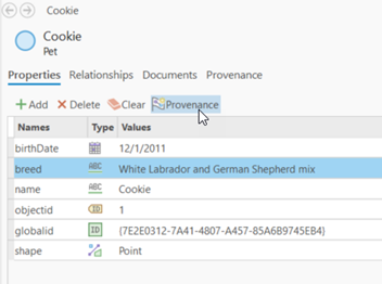

Add provenance from the Properties tab
As you view the properties of an entity or relationship, you can define the source of a property using the Add Provenance dialog box.
  1. Select an entity or relationship in the investigation.
  2. In the investigation's details panel, click the Properties tab.
    All properties of this item are listed.
  3. Click the property for which you want to provide source information.
  4. Click the Provenance button at the top of the properties list.

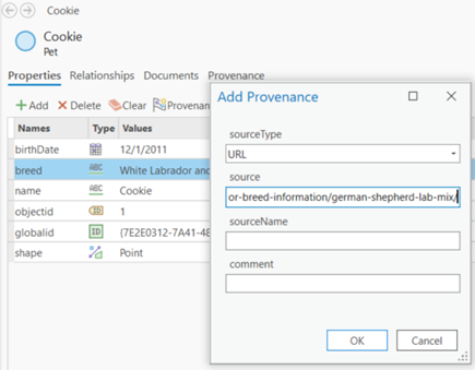

    Click the Provenance button at the top of the list of properties to open the Add Properties dialog box.
    The Add Provenance dialog box appears.
  5. In the Add Provenance dialog box, click the sourceType drop-down list and click the value associated with the type of source information you will provide.
  6. Click in the source text box and provide an appropriate value that defines the source.
    • Document—Search for the document by typing a complete or partial word from the display name or a property of the document entity. Documents with property values that match or partially match the text you typed appear in a list. Hover over a document to determine which is the correct source and click it in the list.
    • URL—Type a URL or a network file path.
    • String—Type the source information.
    Type a URL that identifies the source of information stored in the property.
  7. Optionally, click in the sourceName text box and type the title of the website or file name of the source.
  8. Optionally, click in the comment text box and type information about how the source material defines the property value.
  9. Optionally, if any additional properties are available in the Add Provenance dialog box for the provenance record, provide the appropriate values for those properties.
  10. Click OK.

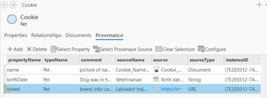

Add provenance from the Provenance tab
Define the source of information for a property of the selected entity or relationship by adding a new provenance record to the bottom of the list on the Provenance tab.

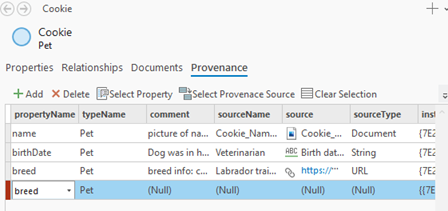

  2. On the details panel, add a new empty provenance record to the bottom of the list on the Provenance tab.

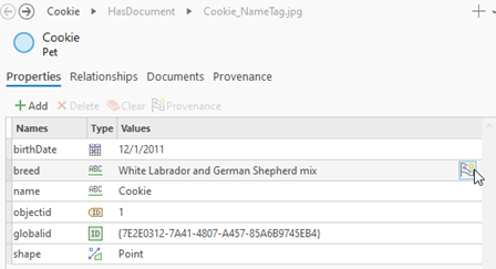

    • On the Properties tab, hover the pointer over the property for which you want to provide provenance. Click the Add Provenance button that appears. The name of the property associated with the provenance record is set automatically.
      Hover over a property and click the Add Provenance button.
    • On the Provenance tab, click the Add button at the top of the list. On the drop-down list for the propertyName column, click the property for which you want to provide source information.
    The Provenance tab is selected. All existing provenance records for this item are listed, and a new empty provenance record is added to the bottom of the list.
    A new empty provenance record is added to the list.
    By default, the typeName column contains the name of the entity type or the relationship type of the selected item. The instanceID column contains the globalid of the selected entity or relationship. The propertyName column contains the name of the property selected on the Properties tab or the value you clicked in the list.
  3. Click in the sourceType column and click the value associated with the type of source information you will provide.
    Click the type of source information associated with this provenance record in the drop-down list.
  4. Click in the source column and provide an appropriate value that defines the source.
    Documents matching the text you typed appear in the search results list.
  5. Optionally, click in the sourceName column, type a name for the source, and press Enter.
    For example, type the title of the website or file name of the source and press Enter. If you selected a document as the source, the sourceName column is populated with the value of the name property from the selected document entity.
    The document's file name is automatically recorded in the sourceName column.
  6. Optionally, click in the comment column, type a description, and press Enter.
    For example, provide information about how this source confirms the value stored in the property of the entity or relationship.
  7. Optionally, if any additional properties are available for the provenance record, click in those columns and provide the appropriate values.
  8. Click Apply at the bottom of the Provenance tab.
  9. On the Investigation tab on the ribbon, in the Manage Edits group, click Save.
  10. Click Yes in the Save Edits dialog box.
The new provenance record is saved in the knowledge graph.

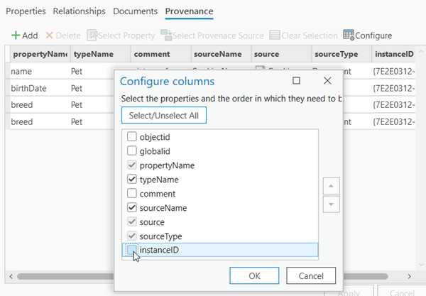

Configure columns on the Provenance tab
A provenance record can have many properties. You can configure which columns appear on the Provenance tab to see only the properties you need.
  2. On the details panel, click the Provenance tab.
  3. Click the Configure button at the top of the list.
    The Configure columns dialog box appears.
  4. In the Configure columns dialog box, check the provenance record properties you want to see and uncheck the properties you want to hide.
    Properties are checked and unchecked in the Configure columns dialog box.
  5. Click OK.
    Only the checked provenance record properties appear in the list.

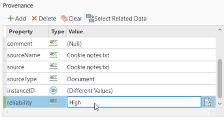

  4. Select all the provenance records listed at the top of the details panel.
    Properties of the selected provenance records are listed at the bottom of the details panel.
    Select all the provenance records at the top of the details panel.
  5. Click Add at the top of the list of properties.
  6. Scroll down to the new empty property that has been added to the list.
  7. Type a name for the new property in the Property column and press Enter.
  8. Click the appropriate data type for the property in the Type column.
  9. Click in the Value column and type a suitable value.
    Type a property value that applies to all selected provenance records.
  10. Click Apply at the bottom of the Provenance tab.
    The details panel is refreshed to accommodate the new property that was added to all selected provenance records.
    The new property appears in the provenance records list.
