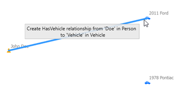

    Before you click the destination entity, a pop-up appears indicating what type of relationship will be created between the source entity and the entity under the pointer. The pop-up identifies the two entities and their entity types. If this is the relationship you want to create, click the destination entity.
    A pop-up indicates what relationship will be created.
    The relationship is created and appears in the link chart as a line with an arrow pointing from the source entity to the target entity.

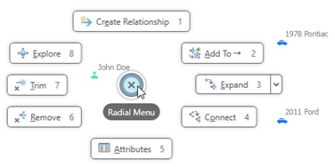

  4. Select the Create Relationship tool.
    • Press R. The radial menu opens and shows operations supported for the selected graph items. Press 1 to select the Create Relationship tool .
      Radial menu for selected entities and relationships in a link chart
    • On the Edit tab on the ribbon, in the Knowledge Graph group, click Create Relationship .

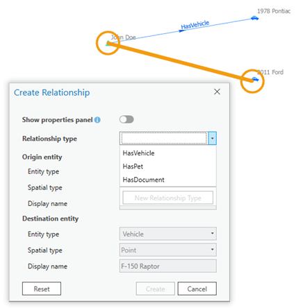

    An orange circle appears around the selected entity that will be the origin of the relationship, and an orange line appears that allows you to draw the relationship.
  5. Click the destination entity in the link chart.
    • Hover over the destination entity on the link chart. When an orange circle appears, click the entity.
    • Click an empty space on the link chart to identify an entity that is not present as the destination entity.
    The Create Relationship dialog box appears.
  6. Click the Relationship type drop-down list and click the type of relationship that exists between the two entities. Alternatively, type the name of a new relationship type to create.
  7. Optionally, click the Swap Origin/Destination Entity button to reverse the direction of the relationship.

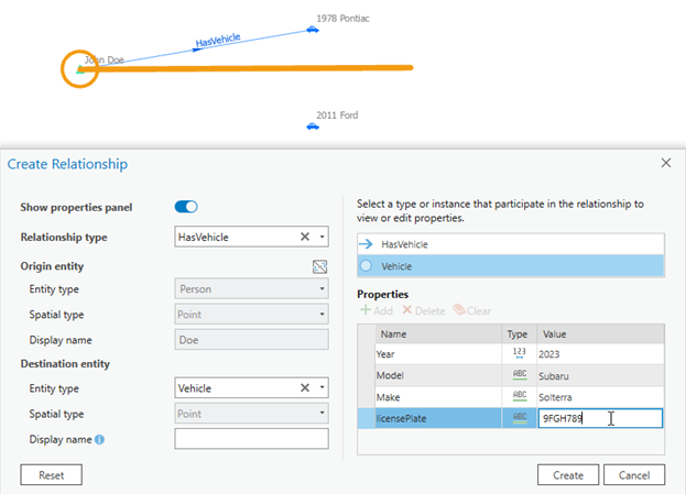

  9. Optionally, define properties for the new relationship and the new entity, as appropriate.
    1. Click the Show properties panel toggle button.
      A panel appears at the side of the dialog box. The relationship type is listed at the top and selected.
    2. Define properties for the new relationship. For an existing relationship type, click a property, click in the Value column, and type a suitable value. For a new relationship type, define a new property, click in the Value column, and type a suitable value.
    3. To define properties for a new destination entity, click the entity type at the top of the panel. Define properties for the entity in the same manner as you define properties for a relationship.
    Define properties in the properties panel of the Create Relationship dialog box.
  10. Click Create.
